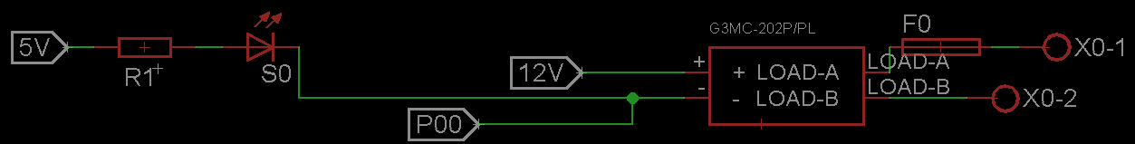

Hi Fernando, First of all I don´t have any idea about electronics so I have been looking for a 2A relay PCB schematic, or better directly one of it just ready to buy, but I hvaven´t fopund any reference at the forum. I supposed you´ll have planned to sell it, or just planned to recomend someone who have it, could you please give me a reference? or in case that you haven´t do it, is anwhere at the forum a schematic or a pinmap of those PCB in order to request a friend to produce it for me?
Sorry for the questions about electronics but I have no idea of it, and my friend told me that maybe with a pinmap of the PCB he could try to create it.
thank you in advance again.
PD: have you the pinmap or an idea when you could sell the rest of the PCB to connect to the ferduino? :ymhug:

The circuit for my relay board is simple.
R1 = Resistor 1 K
S0 = LED
F0 = Fuse 220 V / 2 A
X0 - 1 and X0 - 2 = Terminal block.

thank you very much Fernando, we´ll try in this way.
muito obrigado again. :ymhug: .
