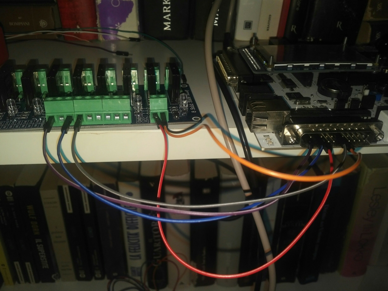

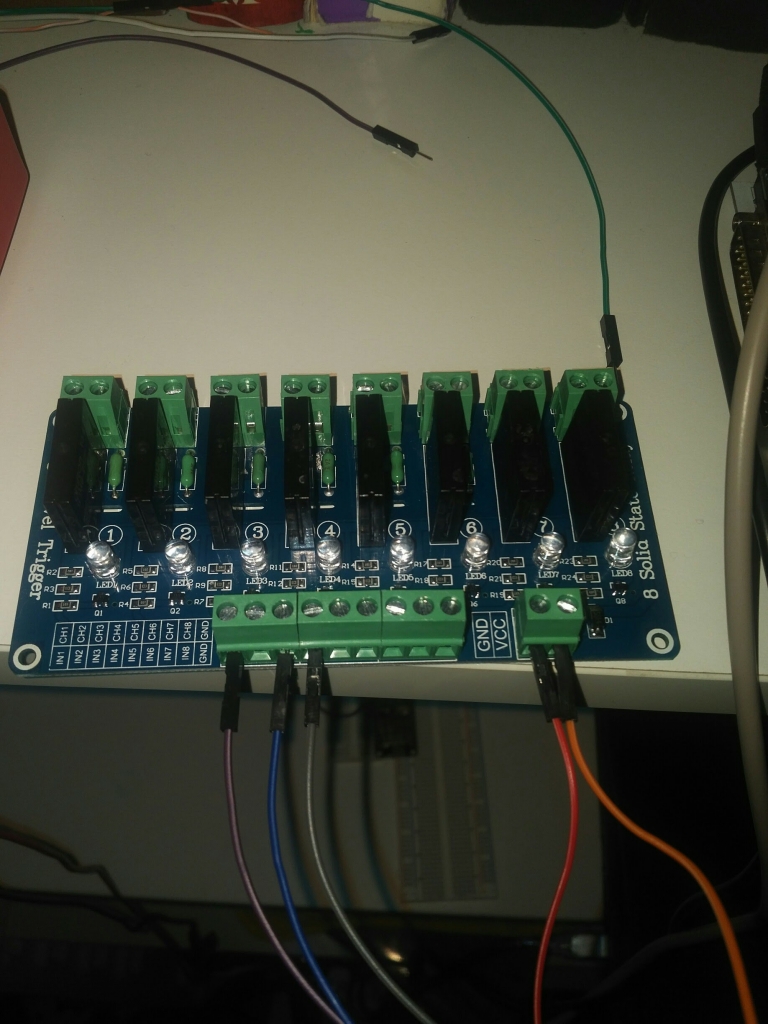

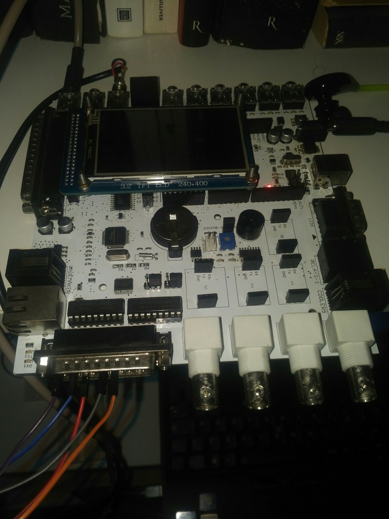

hi!
I tried to do as you told me, but the relay remains off.
I took some pictures.
do I have to change the code?
thank you!
Last edited by Fernando Garcia on Sat Feb 03, 2018 8:48 pm, edited 1 time in total.
Reason: Please use tags [img=left][/img] to post images.
Post Number:#6 Post Sat Feb 03, 2018 8:49 pm
The wiring seems wrong to me.
Check the pin map again: http://ferduino.com/wp-content/uploads/ ... PinMap.pdf
Also try first with test code for PCF8575 available on forum.

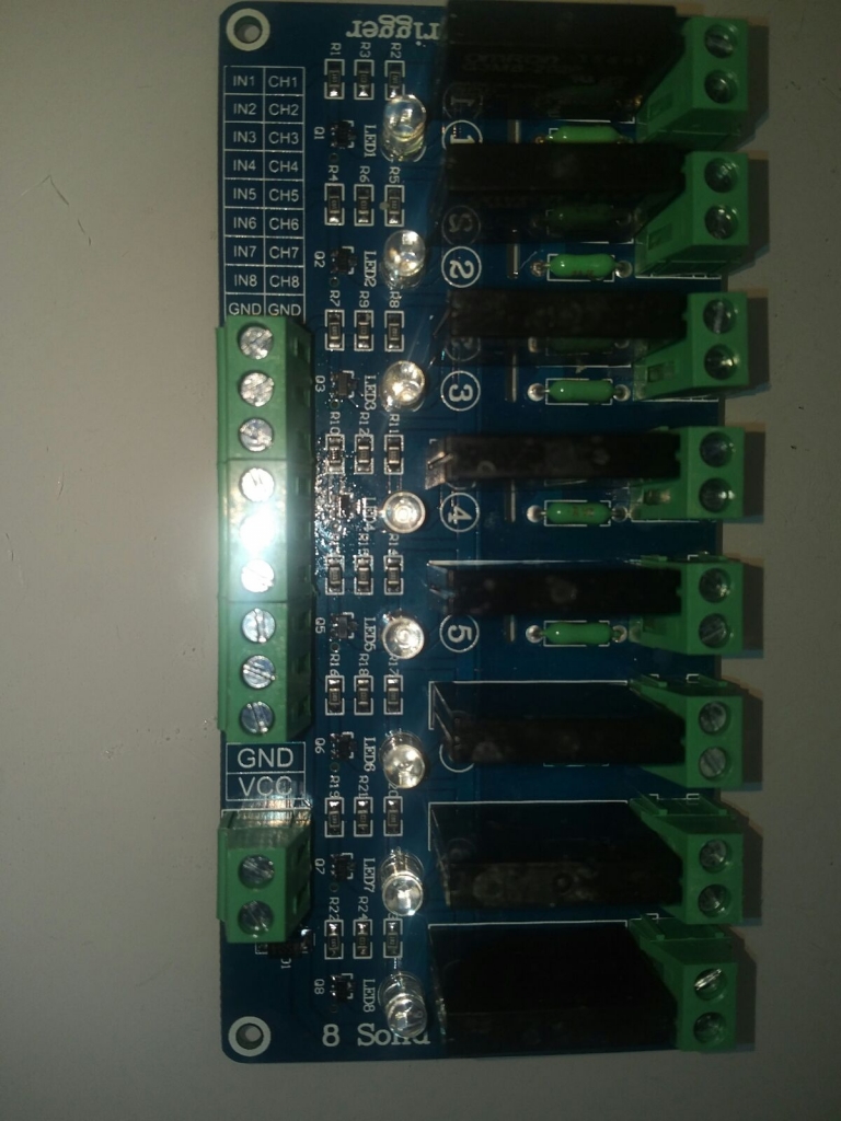

This relay board is low or high level trigger?
Post Number:#8 Post Sun Feb 04, 2018 3:15 pm
Posts: 33
Topics: 10
Images: 8
Solve rating: 1
Joined: Wed Jan 10, 2018 7:30 am
Topics: 10
Age: 45
Italy
high level trigger!
I used another one (not solid state) and it works.

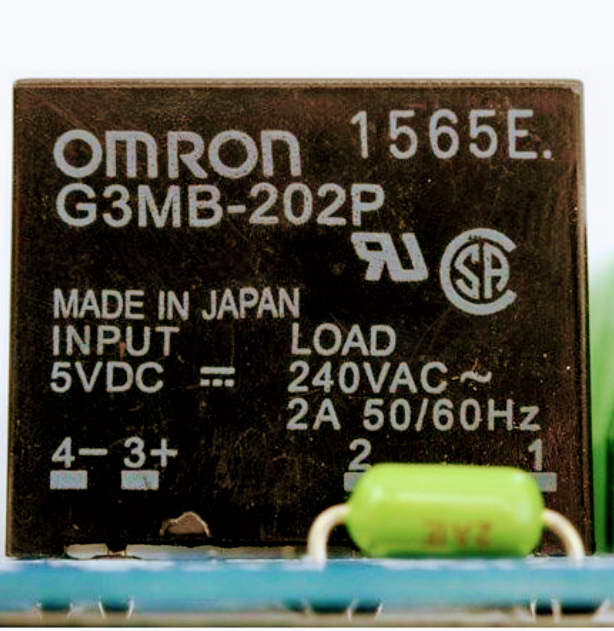

Is there a way to use those high-level solid state?

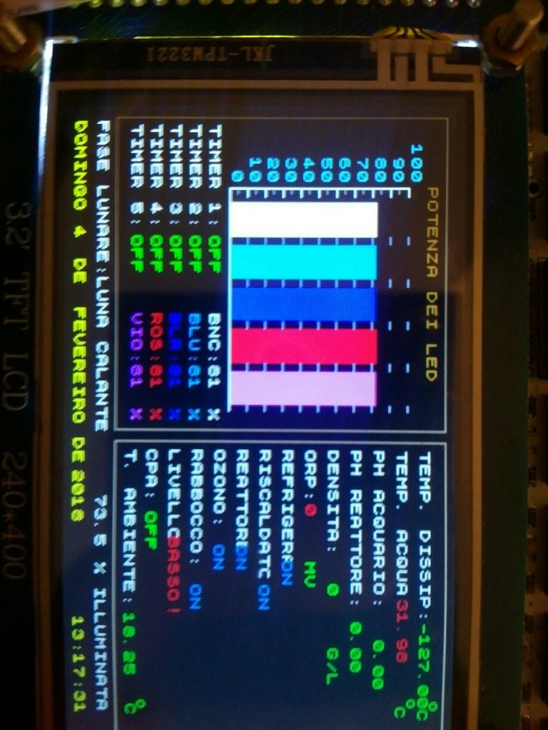

I also noticed that on the LCD the heater(riscaldatore) is always on even if the temperature of the probe is over 26 degrees. It's correct?

To use a high level trigger (active high) you should remove the ULN2803 as explained here: viewtopic.php?f=6&t=100
Should I just replace the pin number on the line "const byte aquecedorPin = 42; // Pino que liga or aquecedor" or do I have to do anything else?
Is needed change other lines. This SSR is rated in 2 Amper it's enough for your heater?
Not, you are doing something wrong because heater and chiller can't stay ON simultaneously.
Default code prevents this behaviour.

for the problem of the heater and the chillers that go together. I installed the code without any changes but the problem remains.
what can it be? I also disconnected the probes.

I do not know why but I set again the temperate and now it goes
