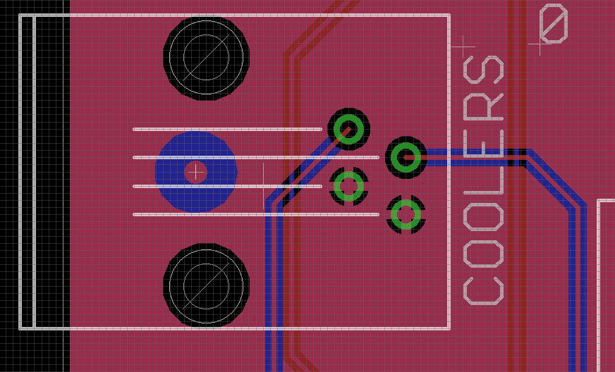

Still waiting on the ground rod from BRS. but did some other things in the mean time got the LED lights running, dosing pumps are all set up and ready to go, I did get a new EC stamp but I cannot use it till I figure out why the other one blew up same with the ORP stamp. Fernando this one is for you,I was checking the coolers jack witch should have 2 GRND by your schematics but one those GRND is live could that be the same line that is shorting out my stamps and the TX side of the Ethernet?
Happy reefing to all.
Post Number:#173 Post Thu Feb 26, 2015 2:31 pm
Only 1 GND live is impossible because all are connected.
Look to PCB design:
