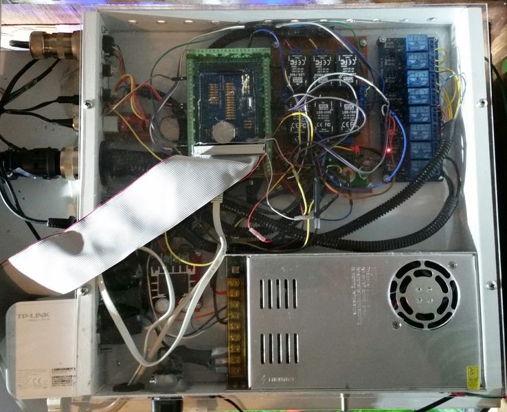

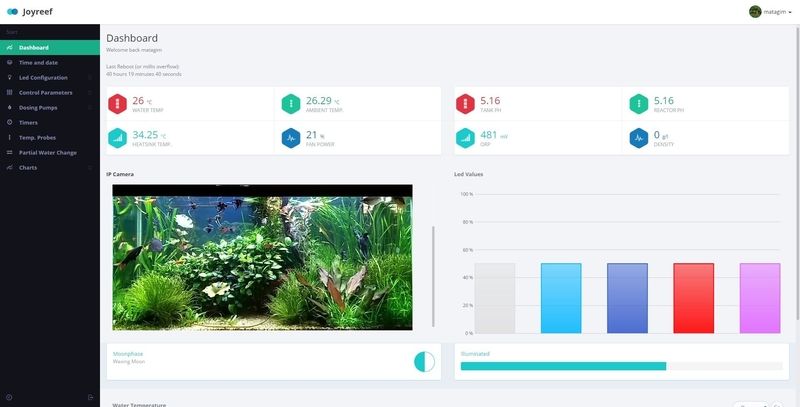

I have just completed my Ferduino build, and I am quite happy with it :) . First of all, I would like the thank Fernando for the software and support with some issues that I had. I will upload more photos with time, but I will upload the basics for now. Everything is functional, except I only use one pH probe, so ORP and Density values are incorrect. I have a feeder using a dosing pump, and I use a dosing pump pin for PWC, as I require a different system for my tank. I am really enjoying this project so far B-) . This is a freshwater tank too, in case some numbers look different.
Top View of my Ferduino Build, I know it is a little messy. =))

JoyReef Info, Charts look nice, and IPCamera is used on one of my old android phones.

Welcome Michael!
Glad to see your controller working. :)
Regarding PH, ORP and density, you can disable this readings on code.

This knob on front panel is for backlight?
Some suggestions:
1 - Maybe removing the enclosure of this power supply can improve the ventilation;
2 - Maybe you can place the mini router between the power supply and relay board;
3 - A frame like this hiding the screws on front panel will be better.
Some suggestions:
1. Yes, the knob on the front panel is for the backlight of the screen. It dims it or completely shuts it off.
2. The enclosure idea is a great idea, I will have to see if I can remove the sides of the enclosure. The top of it can come off easily. I would have to mount the fan on the glass cover, because it is mounted on the enclosure.
3. The router may fit in between there, I originally kept it outside to see if signal strength will be good. The signal is still strong, so I will try to move it in, it would be a close fit.
4. The front panel frame was a quick design so it can stay on the front of the tank.
5. In the next couple months, I am making a new build for another tank. I will probably use all of those ideas to improve on my design. This build is more of a test, and a first build for an aquarium controller, but it is working very well.
