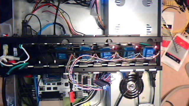

o so I changed a couple of them and know they are working as needed, any word on new boards yet? also I redesigned my relay setup I think this will work very well for me. pics are soon to come.
Happy reefing to all.

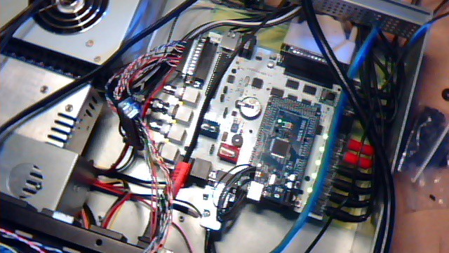

Post Number:#193 Post Fri Apr 10, 2015 5:52 pm
Posts: 275
Topics: 6
Images: 46
Topics: 6
Age: 44
Location: Byers
Post Number:#194 Post Sun Apr 12, 2015 1:10 pm
I haven't news about the boards.
This enclosure seems better.
Post Number:#195 Post Sun Apr 12, 2015 9:36 pm
Posts: 275
Topics: 6
Images: 46
Topics: 6
Age: 44
Location: Byers
yes I was able to fit more into it, and start from scratch not with an old pc case. It is still a little tight.
