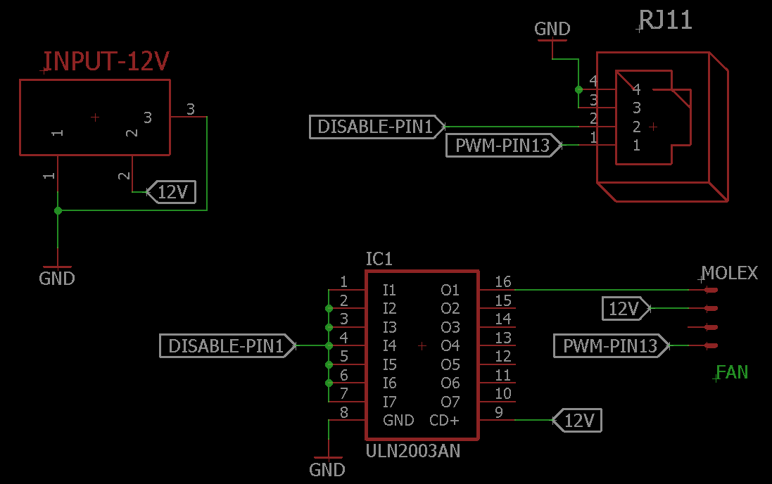

All has been working well for a week now, I do have a question how do you connect the cooling fans for the LEDs? My fans have 3 wires red, black and, yellow. I have looked through many pages and cant seem to find what I am looking for. A fan with 3 pins can only be turned on and off correct?

Pin 1, pin 13 (PWM) and GND are available on connector RJ11.

pin 1 and 13 are (pwm) control speed, what for just on and off? fans with 3 pins are just on and off not pwm correct.
Happy reefing to all.
Post Number:#215 Post Sun Sep 27, 2015 11:43 pm
Pin 1 to disable fan.
Pin 13 to control speed.
const byte desativarFanPin = 1; // Pino que desativa os coolers.

how do you make the connection to the fan?
Post Number:#217 Post Mon Sep 28, 2015 9:09 am
Using this circuit:
You can add a terminal block to fan, RJ11 to control and a jack to 12V in a small PCB.
Post Number:#218 Post Mon Sep 28, 2015 12:49 pm

On RJ 11 jack pin 1 I have connect 12 power supply in line with fan then the ground goes back to the jack as well?

I am being very cautious as I do not want to hurt this board, does the 12 volts go in line with the disable pin? As in parallel, or am I seeing that wrong? Then ground goes back the RJ11 jack.
