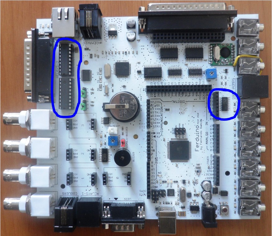

Post Number:#236 Post Wed Sep 30, 2015 10:46 am
I have always the sensation that you are talking about this components.
Left corner:
2 x ULN2803 connected to DB25 used for relays.
Right corner:
ULN2003 connected to RJ45 used for dosing pumps.
The board haven't any circuit for fans. Have only a connetor RJ11 to make the wiring more easy.

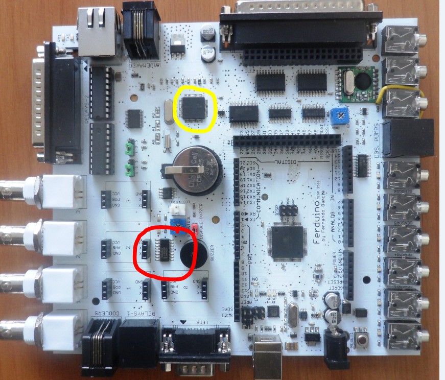

Post Number:#238 Post Wed Sep 30, 2015 12:48 pm
As your stamps are working with new board the problem in old board should be the multiplexer.
Try replace the 74HC4052 marked in red.
http://www.digikey.com/product-search/e ... -1456-2-ND
Maybe replace the W5100 (marked in yellow) can solve the problem the problem with ethernet.
http://www.digikey.com/product-search/e ... 78-1002-ND
On this way you can use all circuits so when you have all working can use the new board definitively.
