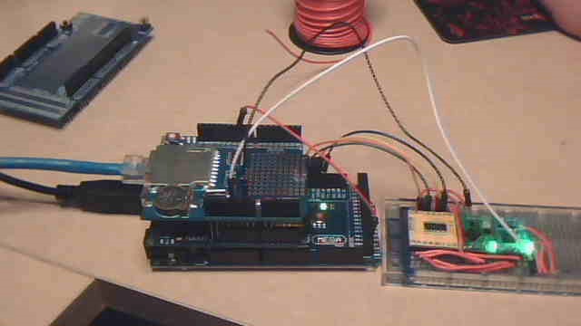

I got it to work on separate Arduino I will post step by step and add comment tomorrow I have get to bed for work tonight :-B
No multiplexer just prototype shield and Arduino Mega 2560.
1) 5 volt from 2560 to VCC on stamp.
2) ground to ground
3) TX3 from 2560 to RX on stamp.
4) RX3 from 2560 to TX on stamp.
5) Connect USB to 2560.
open IDE>open file EZO Mega> keep BAUD rate the same (9600) for the first load of code> load code> open serial monitor> send this: serial,38400<cr> next in IDE change the SERIAL(9600) to SERIAL(38400) load new code to 2560 open the serial monitor change baud rate to 38400 and send this c,0 to stop constant read then send this (serial,?<cr>) response should be (?*OK,38400)
THIS WAS NOT DONE ON FERDUINO BOARD WAS ON A STAND ALONE 2560 AND PROTOTYPE SHIELD.
I was talking about a step by step to a full controller, because you are starting from ground.

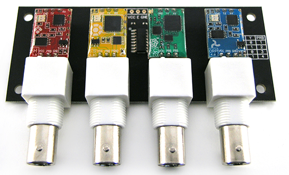

Fernando have you seen this?
I found it atlas scientific
Image: http://www.ferduino.com/forum/gallery/image.php?album_id=17&image_id=381
I'm the founder of Whitebox Labs. We're the maker of the product you posted there.
First of all, great build you did here. I wondered if you have some pics of your tank somewhere? I'd love to see it.
I've noticed you and some others here had troubles making the EC circuit play nice. Simply put, there is an issue of crosstalk between the EC and other circuits when used in the same closed / common ground system. The reason for this is the way the EC probe works. The probe basically applies a voltage between 2 points internally to measure the conductivity of the water. The other probes (e.g. PH) are influenced by that voltage and will give wrong or unstable readings.
So IF you're using the EC circuit, there's no way around individual circuit isolation - if you need stable and exact readings, that is. But there are more reasons for isolation, even if you're not using the EC circuit. An aquarium can be quite noisy, electronically speaking. Pumps in the water, or lamp ballasts close to the water can introduce noise and stray voltage. If you can see your readings jump when switching on/off lights or other aquarium devices, that's why.
Of course we all know that the circuits, probes, calibration solutions et cetera add up to a price! Isolation adds even more. But it's a small price to pay for stable and accurate lab-grade readings. Having an isolated circuit offers more accuracy than the rolls royce of probes connected to an unisolated circuit.

  • For Ferduino users, you should get Fernandos new iso module.
  • On a breadboard, the Atlas Scientific PWR-ISO is an affordable way to isolate up to 2 channels.
  • On a normal 5V Arduino, the Tentacle Shield might be an option for you.

This interference between EC and others stamps was found recently by Atlas Scientific.
Previously in Atlas site's the image for carrier board was:
Now is:
Including the message marked in red.
Sometimes the electric noise can be minimized using an average of values and/or ground probe but, the best option is use the isolator.

The Tentacle shield isn't simple to use with Ferduino controller because it's for Arduino Uno so, user will have problem to stack others shields.

Your iso shield is based on the Tentacle Shield design, right? I assume you will respect the spirit of open source and release it under the same license (CC BY-SA 4.0). Thank you.
Yes I think using the Tentacle on Ferduino is not optimal. While certainly possible, it does not make a lot of sense. Except you need 8 or 12 sensor circuits on your Ferduino :D
However, have you had a look at the "Setup Sketch" i linked in above? It might be useful, also to set up the Atlas circuits on Ferduino (without using Tentacle at all).

Post Number:#278 Post Sun Nov 22, 2015 3:07 pm
Posts: 274
Topics: 6
Images: 46
Topics: 6
Age: 44
Location: Byers
yep I forgot how important it is to start with a fresh SD card, Thanks Fernando. ^:)^
still the same results, it will connect once then not again.
Happy reefing to all.
Post Number:#279 Post Sun Nov 22, 2015 5:50 pm
Posts: 274
Topics: 6
Images: 46
Topics: 6
Age: 44
Location: Byers
At this point I have done the following,
1) reformat card 3x
2) changed speed in all 3 ranges half, full and, quarter.
3) changed gateway in multiple ways.
4) did the changes to the D1307.h and D1307.ccp files as well.
I did go all the way through the with web control setup, checked for the changes in webserver and ferduino tabs to make sure they were okay, All of these files are from the new down loads from forum or github.
here is the setup code. To change speed.

here is the ferduino tab.
//************************* Funções do ethernet shield ************************************
boolean Ethernet_Shield = true;                     // Change to "false" if not connected to an Ethernet Shield Arduino .
const char *Username  = "ckindig123";               // Place here the user name registered in joy-reef.com
const char *APIKEY = "91733d7";                     // Cole here ApiKey generated by joy-reef.com
const byte maxima_tentativa = 3;                    // Maximum number of authentication attempts .
const byte intervalo_tentativa = 15;                // Waiting time (in minutes ) for retries.
byte mac[] = {0xDE, 0xAD, 0xBE, 0xEF, 0xFE, 0xED}; // The MAC must be unique on your local network .
byte ip[] = {192, 168, 0, 139};                     // Configure the IP according to its local network.
IPAddress dnsServer(8, 8, 8, 8);                    // Configure the IP according to its local network. This is Google's DNS is generally not necessary to change .
IPAddress gateway(192, 168, 0, 1);                  // Set the " Gateway " as their local network.
IPAddress subnet(255, 255, 255, 0);                 // Configure the network mask as your local network .
EthernetServer server(5000);                        // Insert here the number of the configured port on your router to redirect.
                                                    // The port number must be compulsorily either: 80 , 5000, 6000, 7000, 8000, 8080 or 9000 .
unsigned long intervalo = 0;
char *inParse[25];
boolean web_teste = false;
byte tentativa = 0;
boolean web_dosage = false;
unsigned long millis_dosagem = 0;
unsigned long millis_enviar = 0;
boolean web_calibracao = false;
const char *token = ":";
char Auth1[50];
unsigned long teste_led_millis = 0;
And webserver tab.

so all of the sudden ferduino started working again, all I can figure is me wall wart power is too much at 7 volts and 2 amps but on 6 volt setting is running well and working with joy reef. :D
Time to calibrate the probes and get it back on the tank to test ISO in real time. Again thank you for your help Fernando.
