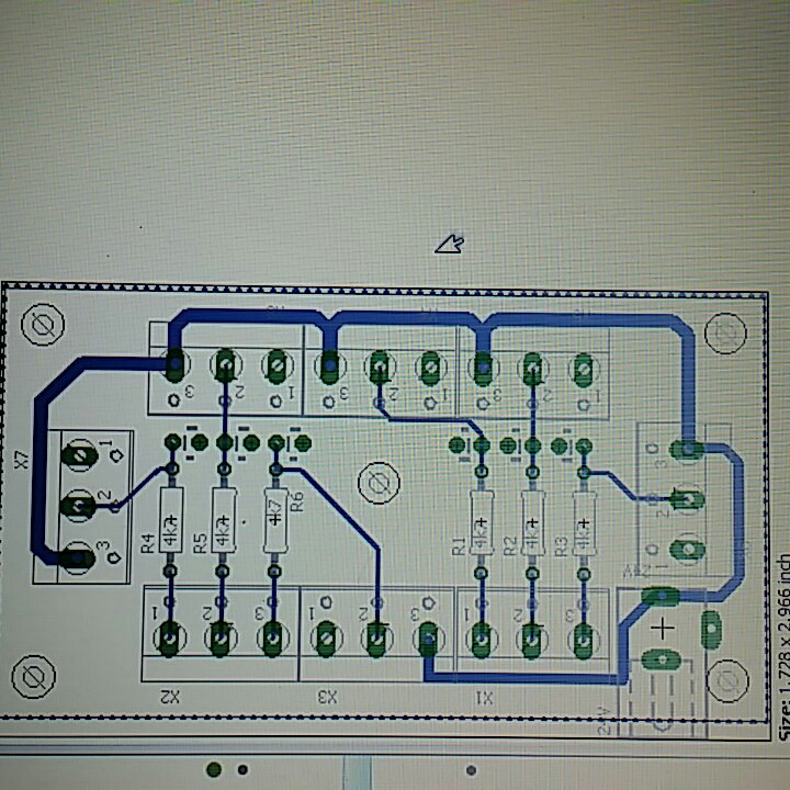

on pin outs you have RJ-11 as one ground and one 5v, in board you have 2 gnd witch one is correct.
For this PCB the 5V is useless so, do not connect the wire in 5V.
The 5V is useful if you want add a LED on PCB.
There 15 PWM pins but, for DC pumps there only 2 free pins.
You needs use the pins reserved for LEDs or use a PWM expander as PCA9685.

From what I have found the circuit I need to build looks just like the one on the forum only it will have 6 out put connections, I will have one 24 volt+ bus to run all 5 pumps, on 24 v- connected in common with ferduino and pwm expansion, and the I2c communication on its own from ferduino. So I will need an LDD driver I thought I might. Will a LDD 350 be large enough my highest wattage is going to 105 watts, or should I use 1000 LDD? Or should I use this circuit for lights and LED pwm for motor control?
Happy reefing to all.
Post Number:#312 Post Thu Dec 17, 2015 8:01 am
Yes, is right.
In the image above the LDD is your PCB and the LED is your pump.

Ok so I do not need LDD just the circuit board I have been working on. Just need to add connections for the other pumps. I will finish the board layout today can you look and see if missed any thing, your knowledge about this surpasses mine by far.
Post Number:#314 Post Fri Dec 18, 2015 10:22 am
For Jebao pumps the LDD is not needed.
This image is only to show the concept, I mean all GNDs connected and +24V and PWM going directly to your PCB.
Show me the project.
