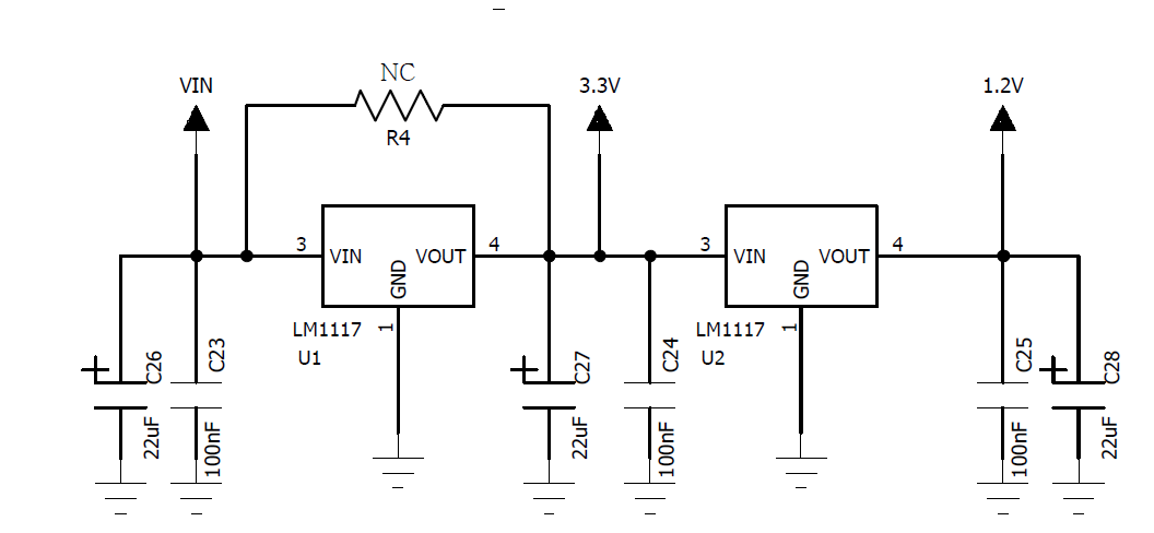

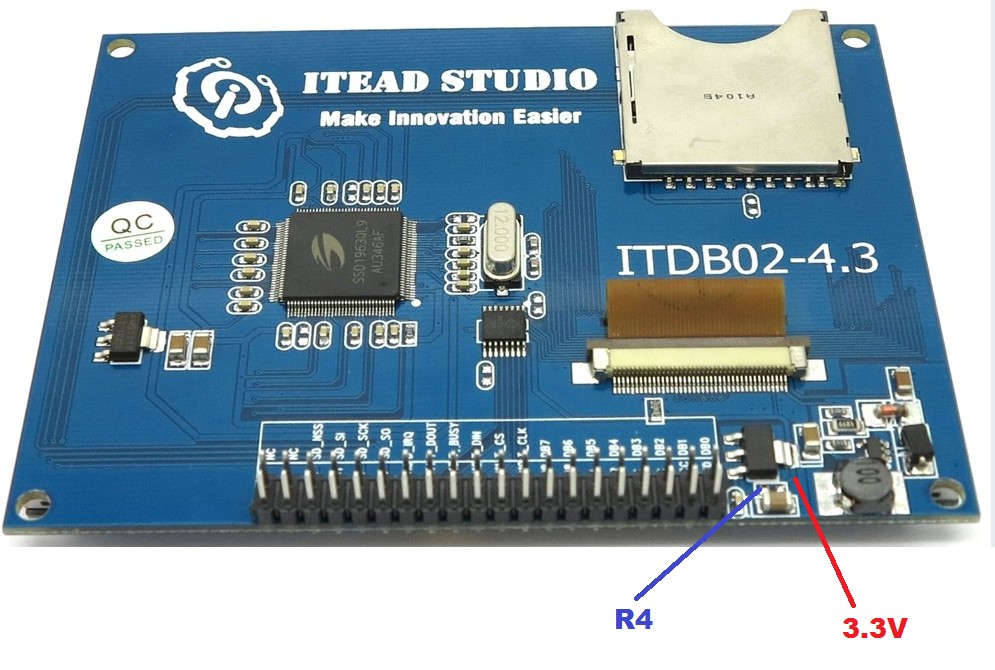

I had a problem with my ITDB32S and SD card.
I solved just adding a shunt on TFT to bypasses the regulator. See the image:
This happens because Ferduino have 3.3 V on TFT header and on TFT after the regulator the voltage is smaller so, the SD doesn't work fine.
But this problem doesn't happens with my ITDB32WD.
You can check the voltage on your TFT after the regulator and if needed add a shunt on pad called R4.
See the schematic:
http://itead-europe.com/pm/display/tft/ ... 02_4.3.pdf
