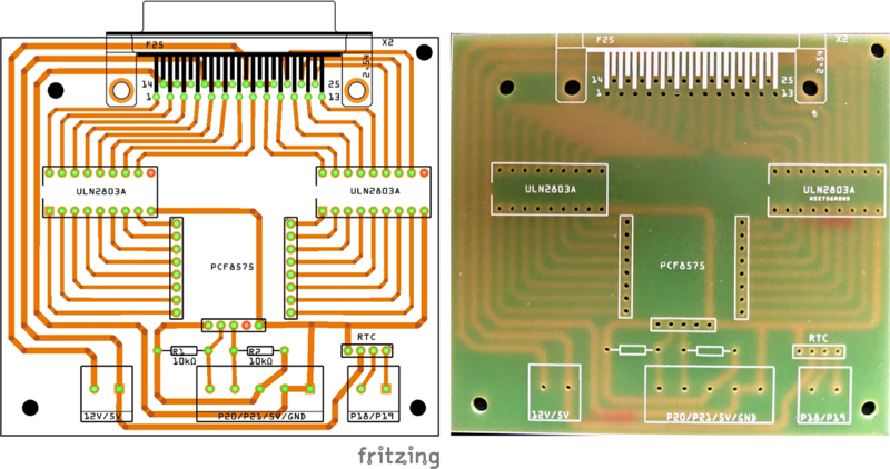

Finally I can show my progress, I have decided to make modules instead of a single PCB and so far I have:
Module 1: Temperature probes, level probes and dosing pumps
Module 2: Clock and Relays-2
Module 3: Alarm and output for surface fans and led fans
Module 4: Dosing pumps module

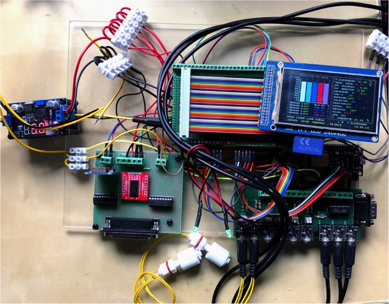

Finally I show a picture of the assembly that I have running at this time, the connection is by WiFi

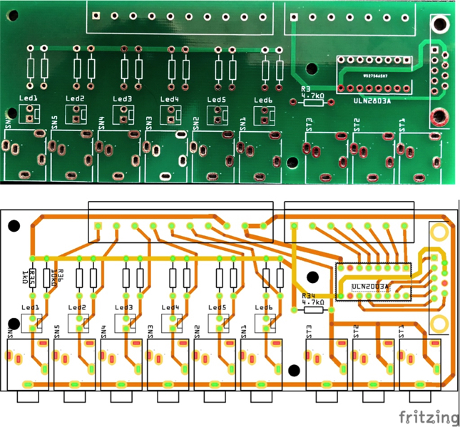

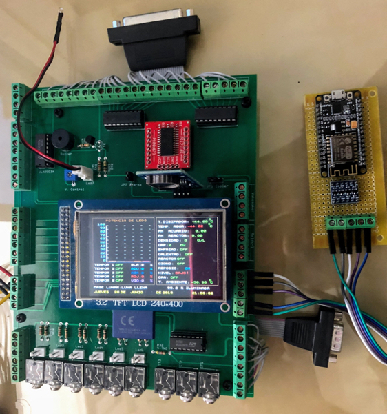

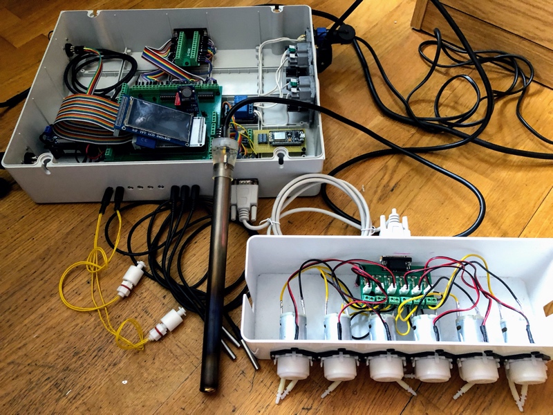

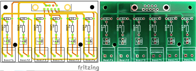

Finally instead of modules I have designed a plate that fits my needs, it is "copied" from Ferduino Mega but with certain limitations and some changes like the possibility of choosing if I want to cool the water by means of surface fans or a cooler. As for the dosing machines I added a led on each PCB to see when they are in operation and to house them I used a box to order cables.
The box to house the shield and other components is commercial and being quite large I have left inside the relays that control the heater and the cooler and at the time I will put Atlas-Scientific modules.
But at the moment I can start.
The next step is to look for a box to install the relay module-2.
