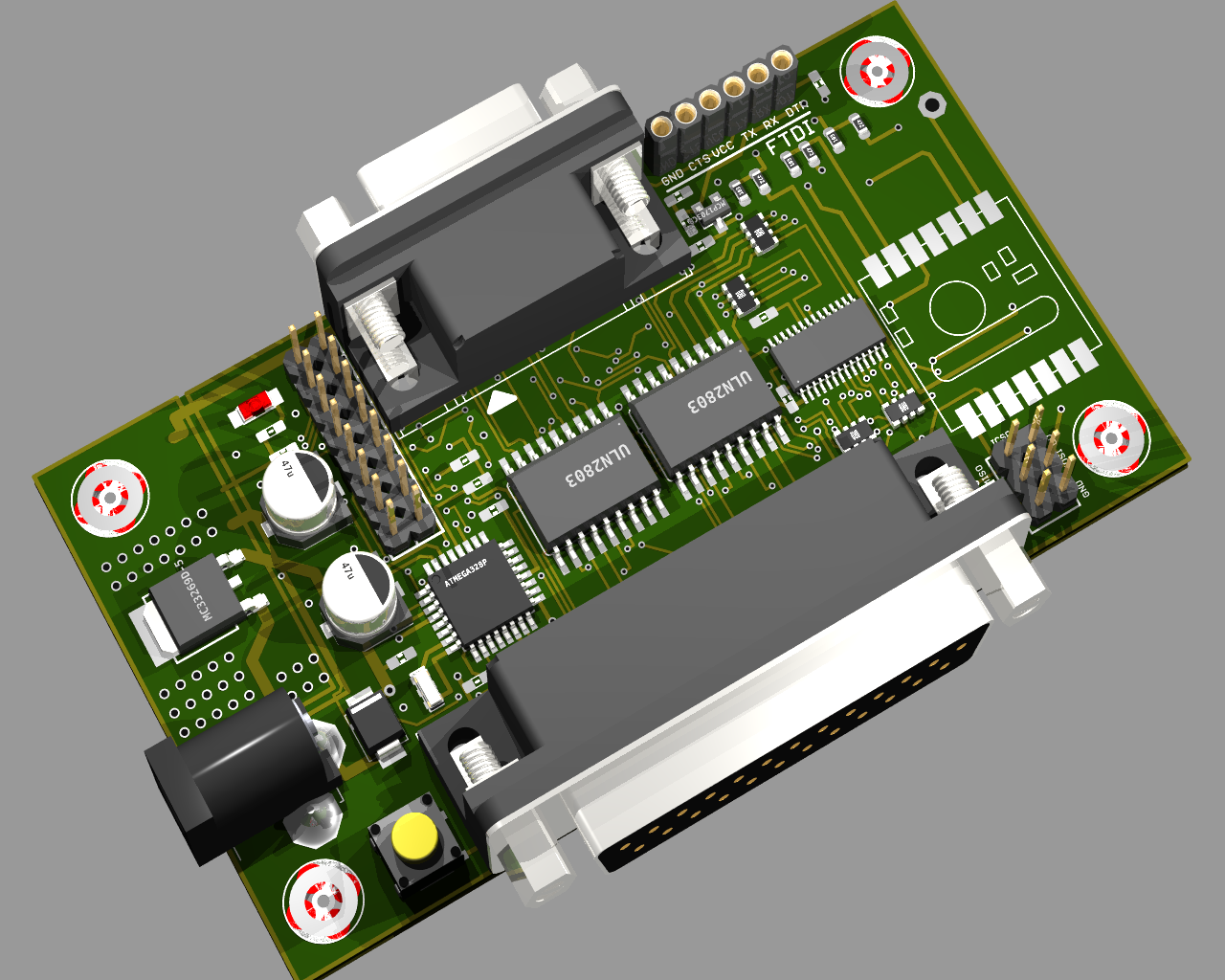

I'm working in a new feature to Ferduino Controller.
I did a small board to control LEDs or relays.
This board will be plug and play to my relay or LDD board.
This board will allow control until 20 LED channels or 23 relays.
For now I'm working with a small board called Anarduino mini wireless but a Moteino also can be used.

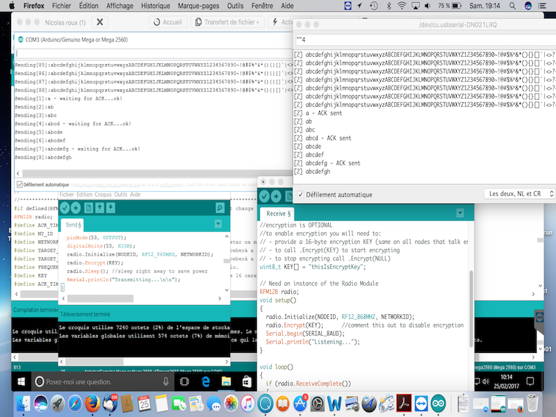

salut
I use your system on my reef lighting and
Function very well :ymapplause:
But I would diminish all these cables
I purchased this module https://lowpowerlab.com/shop/product/100 and
Integrated this module on http://www.digitalsmarties.net/products/rfm12b
To test it I use the Send code on one and Receive on the other
Both work :-bd
Then my question needs a code for my
Https://lowpowerlab.com/shop/product/100 to work with ferduino
Thanks for your help

Post Number:#14 Post Sat Feb 25, 2017 10:16 am
Do you mean ARDUINO MEGA is sending and MOTEINO is receiving?
Or have you tested this code on Ferduino? In this case which code exactly was used on Moteino?

Post Number:#15 Post Sat Feb 25, 2017 3:41 pm
Nicolas, try this codes: https://github.com/FernandoGarcia/Ferdu ... %20control
There a mystery on code, when the PWM value is 0 ou 255 the communication works but doesn't works when is different.

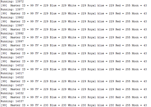

Post Number:#18 Post Tue Feb 28, 2017 8:15 pm
Nicolas, can you give me some feedback about this code?
Here only fixing the value of red LED in 0 or 255 it's working with Ferduino code:
I don't know the reason for now.
I just comment this line is "RFM12B" tab:
  //theData_led.channel_red = rled_out;
