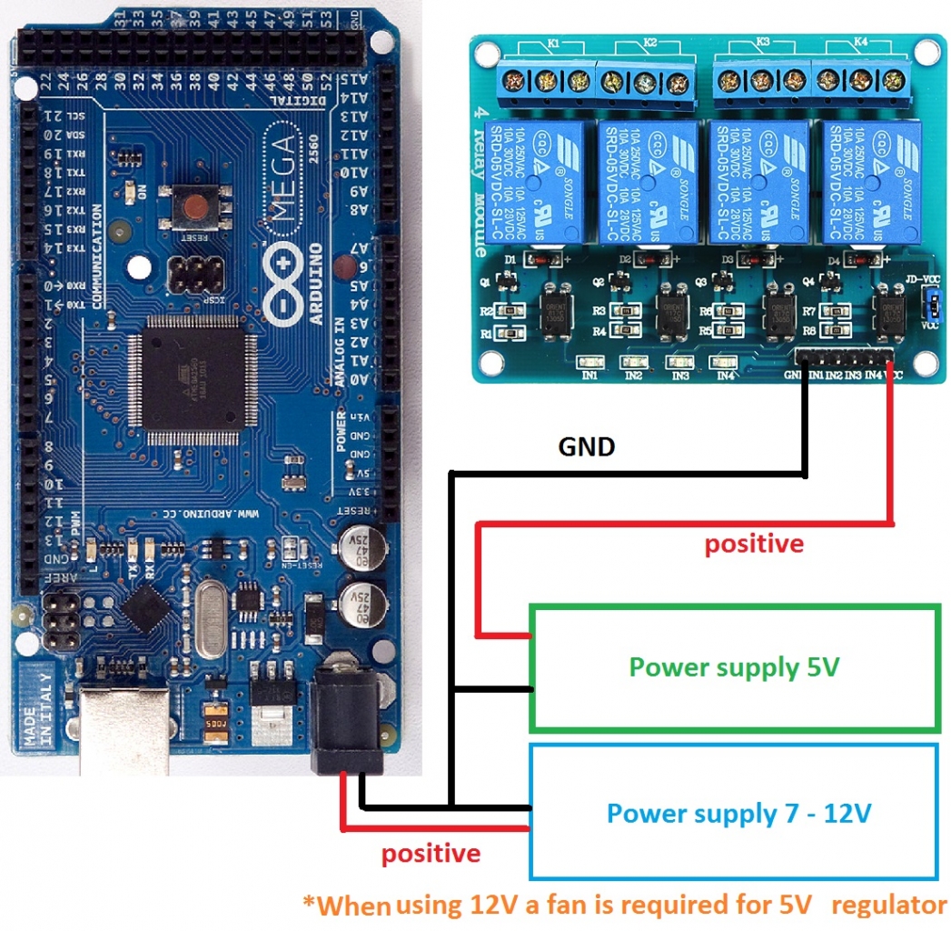

I have another problem, when I put the controller relays these to connect the display off and on .
Ya and I tried disconnecting and thus display works well , and seen only two relays alconectar nothing happens, but when I connect the third and fails, then I guess it's for lack of consumption.
I fed the ferduino 12v 1A will be that few amps ???????

I don't understand fine your question but I think you needs of an external power supply for relays and other devices.
The Arduino can supply only 5V @ 800 mA.
