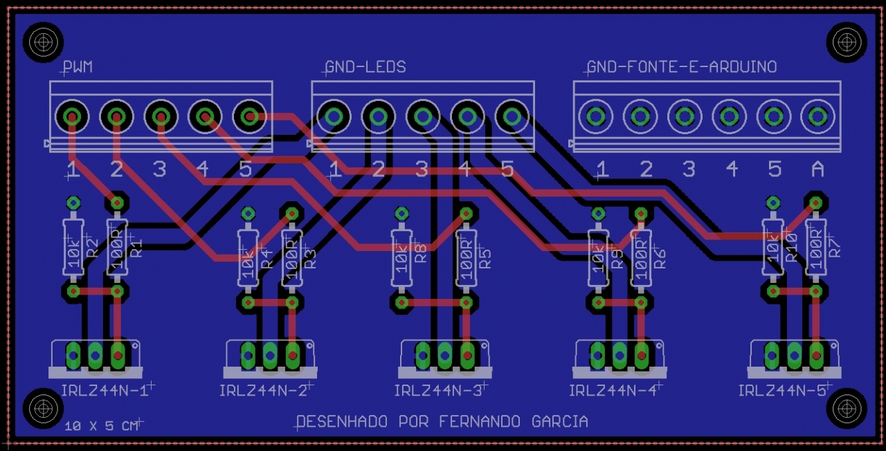

One question: If I'm just going to have LED lights, temperature control fans need all the elements?
Another question: In this image gallery/image.php?album_id=11&image_id=70, what is the function the R2 resistors and the GND-FONTE-E-ARDUINO?

Hi
Post Number:#8 Post Sat Aug 09, 2014 3:47 pm
The R2 is a resistor pull-down, check it : http://en.wikipedia.org/wiki/Pull-up_resistor
"Fonte" in english is power supply, you need connect the negative (GND or ground) from power supply and Arduino on this circuit.
The positive goes directly to the LED.

hi Fer
Sorry to bother you, I'm a bit ignorant on this issue, I have a doubt resistance, for example R2, R4, one leg is not connected to anything, and the GND-Fonte-Arduino-E, also did not see anything connected if I do not understand. That's OK?
Post Number:#10 Post Sat Aug 09, 2014 4:49 pm
No problem.
Look this image.
All this area is a signal of ground, all points highlighted are connected to it.
