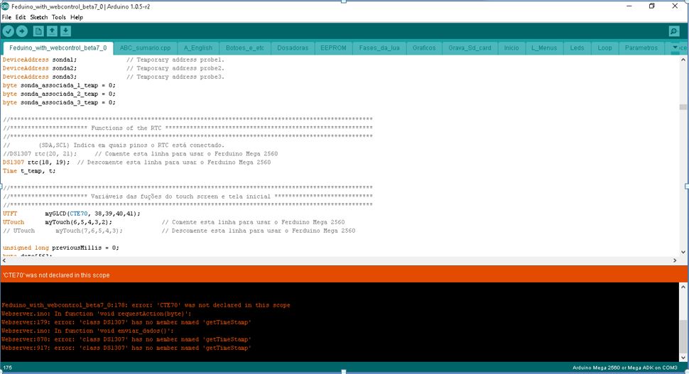

Hi
I already did all of the sequences which you said to follow in your forum. I am using Arduino Beta 7 from Willie and yet I have problems with of the verification from program when I do it. Then I need your help however I searched all in your topic in the forum but I had not results.
The picture below shows the wrongs that the program IDE 1.0.5 come up at screen.

Post Number:#23 Post Thu Nov 12, 2015 9:35 am
1- Use libraries downloaded with Willie's code!
2 - Change the RTC librarie as explanained here: viewtopic.php?f=8&t=34

Topics: 4
Hi Fernando
I done two step, but the problem was not solved.
Best Regards

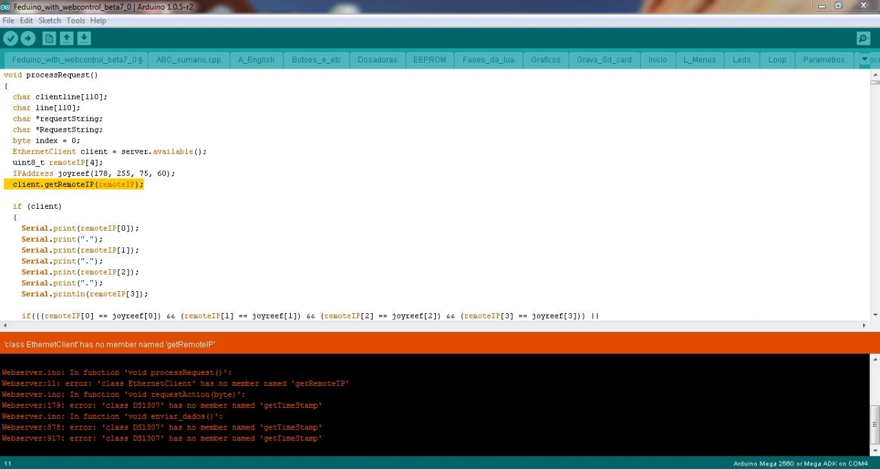

Fernando
Sorry my insistence but I tried all step you recommended and I didn't have success.
Now I disabled the ethernet and continues with same problems in bellow
Could you help me more?
Best Regards
Post Number:#29 Post Tue Nov 17, 2015 9:41 pm
Willie didn't update in ethernet library. On this case you can use this: https://github.com/FernandoGarcia/Fedui ... s/Ethernet
Post Number:#30 Post Sat Dec 05, 2015 8:09 am
I have fixed this issues via Team Viewer.
Willie's code have many problems with outdated libraries and codes incomplete.
