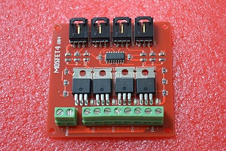

Hi Jamie, sorry for delay in the answer, thanks for your reply! So, i didn't use relay board at the moment, the arduino board is chinese one (sainsmart mega 2560 r3). The only things it control are: led dimming, water temperature, and two float switchs BUT without a pump for ATO, i didn't had time to do it :( anyway i bought two 4 channel fet switch like this:
to control all DC devices (fan, pumps, etc) with a separate dc power supply.
