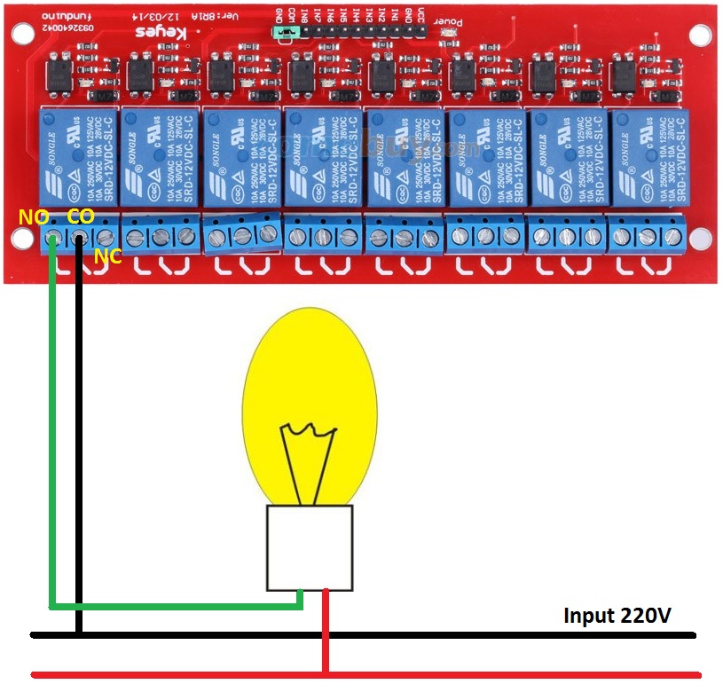

I just wanted to know if the connection is correct for the connection of electrical appliances 220v relay module with this so well and can connect from ferduino lcd
Thank you
Post Number:#6 Post Sat Mar 26, 2016 2:07 pm
The wiring for AC load is like this:
