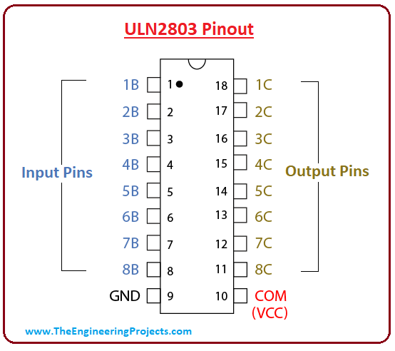

Can you remove the ULN from socket and measure the voltage between pins 1-8 on socket and GND with PCF signal HIGH? It should be around 5 v.
After can you measure the voltage between 5 V and pins 11-18 on socket with PCF signal HIGH? It should be around 5 V too.
Between pins 1-8 and GND (pin 9) it should give around 5 V as I told before.
As I told here with ULN connected the voltage should be around 1.5 V.
Here my question is incomplete. I forgot to say to put the ULN back on socket before measure.
Without ULN the socket pin is connected only to DB25 and it will give 0~1 V only.
With ULN connected between pin 11-18 should give around 5 V as I told before.
