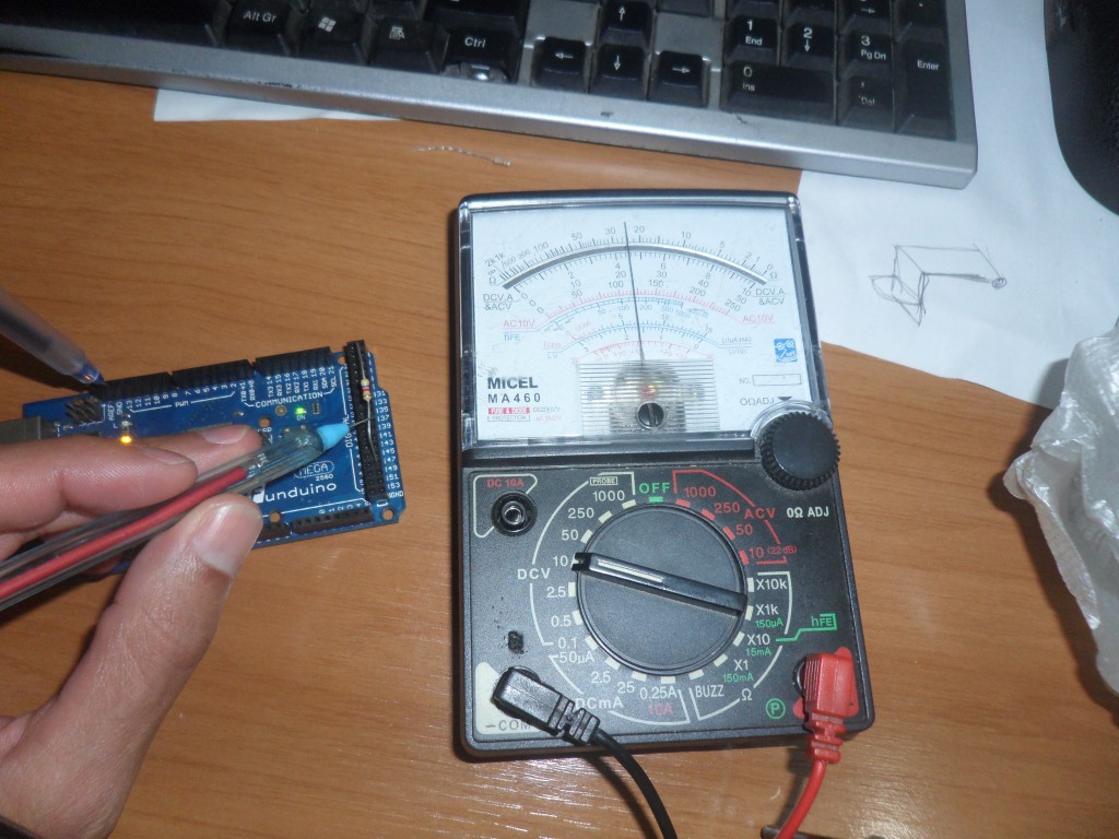

X( I just do what you say. Continuity in the pin 49 to the Arduino if there is. Voltage between 5V and gnd out 4.93 . I have checked the voltage of the output of the resistance and leaving 0.59 . have to give that? If you look i have already joined the gnd with the Vcc in the DS18B20. I would like to search for probes and found nothing
Post Number:#12 Post Sun Sep 13, 2015 5:34 pm
No, should be 5V too. Remove this connector and join the wire and resistor with tin.
Post Number:#13 Post Sun Sep 13, 2015 6:17 pm
Posts: 43
Topics: 11
Images: 4
Joined: Wed Jul 08, 2015 5:32 pm
Topics: 11
Age: 48
Spain
I command thee the two photos and this is the voltage that gives me, before and after the resistance. If i tested on another connector gives me the same thing.

This is the bookstore that load to the Arduino, i command thee this to see if you see something wrong.
Post Number:#14 Post Sun Sep 13, 2015 9:40 pm
Please post images and codes correctly.
Check this topics:
viewtopic.php?f=8&t=32
viewtopic.php?f=27&t=173
This is not a problem of code!
It should be 5V, replace this resistor and/or connector.

Hello Fernando, i just look at it now because before i could not for employment reasons. I just check what thou badest me. Here's the photos of the verification: the resistance is new. As you can see if did not connect the green wire to pin 49 mark 4.90 . This seems to me that is good, but when I connect it to the 49 pin mark 0.59 . It is as if the pin 49 will be the energy if you don't understand something of the photos you can say me.
-------------------------------- Last edited Wed Sep 16, 2015 4:09 pm --------------------------------
Here is without connecting the cable from the middle of the probe, but when I connected the cable mark 0.59

Post Number:#17 Post Fri Sep 18, 2015 1:50 pm
The official version of Ferduino haven't any problem known with temperature sensors, anyway you can try the example available on fórum.
Also can try a new DS18B20.

Hello Fernando, here you control the photos by checking with probe or probe without directly on the plate. I have already tried to delete and download the codes and it still does not work. I will have to buy other probes and test them, I also tried the test code and did not seem to me to find any probe, it's no longer or to look at it. Forgiveness for the pictures, but i come out as the images are well, attempt to do the best i can.

Hello Fernando, this is another test that i have done, without the shield, soldering the wires behind the plate. AND connected the DS18B20, this is how you can see it in the photo, nor found. But now mark on the display -127.00 °C. The resistance is a new one.
Post Number:#20 Post Sun Sep 20, 2015 4:51 pm
Check the menu 2 again.
