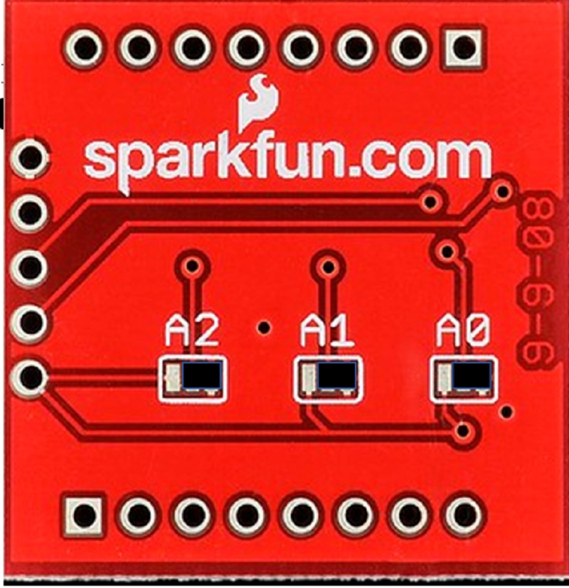

Did you a shunts on bottom side to A0, A1 and A2?
It should be center to right (GND)
Did you a test with this module in a breadboard?

Apologies for entering the thread, as I said to me the same thing happens to Gio. Fernando seeing your answer I think the problem is due to the fact that A0, A1 and A2 are not welded with GND (the Sparkfun shield is the same as the photo you show). I understand that it is necessary to bridge by welding from the central point to the one on the left and free the one on the left at A0, A1 and A2. It is right?
Thank you
Post Number:#39 Post Sat Dec 21, 2019 12:22 pm
José, there's no problem to post here.
Your understanding is right.
I don't think it should be the real problem since when the signal is floating the module is found as 0x20 but just in case.... ;)
I would like to know if you and Gio can make this module work in a breadboard using LEDs in this way:
I think the module is working but there's no enough current to turn the relay ON.
The basic difference between blue and red module is the built-in 3.3 V regulator. Maybe when connected to 3.3V instead 5V the module can send more current to output pins.
