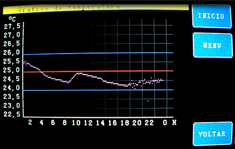

Can you see the graphs on TFT?
Post Number:#11 Post Tue Jan 19, 2016 5:35 pm

Post Number:#12 Post Tue Jan 19, 2016 6:01 pm
This:
Try disable ethernet functions, maybe it's conflict.
