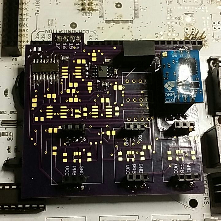

Then I did this shield for Sueur Aurelien using one PWR-ISO from Atlas:
But it's not enough when there an EC and Ph stamp together, so I did this shield with 4 independent isolations for Christopher Kindig.
Now I did a new version for DIY controllers:
PS. This is only a 3D render
To be assembled in a enclosure like this:
I didn't any sample for this board yet but if you are interested I can sell the PCB for you and give the part list to you buy from anywhere.
The price for 3 PCBs (MOQ) from OSH Park is $ 63.80 + Shipping + Paypal fee (7.5%). This value is without any profit to me.
The two PCBs remaining you can assemble and sell to someone.

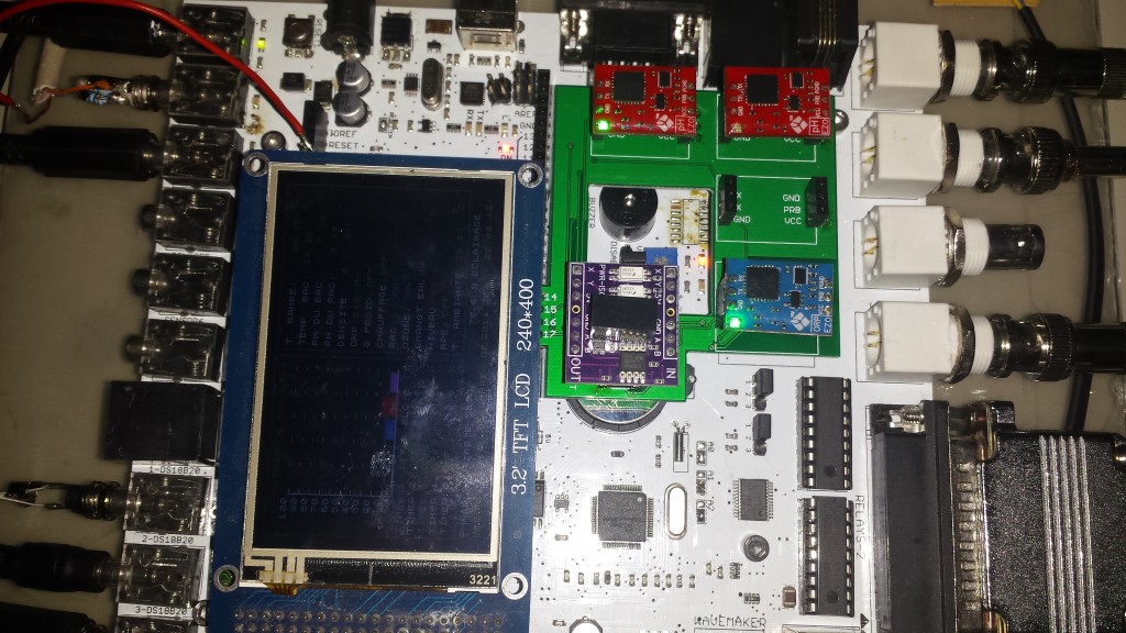

Thank you for your reply, this expansion is exciting, but I prefer it to be all on one PCB, So far I have added CF into PWR-ISO ON Y3, then PH, PH2 and ORP connect in Y2, Y1 AND Y0, finally, RX and TX from 4way multiplex into PWR-ISO, then arduino.
So, CF isolated into multiplex
PH, PH2, ORP not isolated into multiplex
multiplex isolated into arduino.
2x isolators are used.
