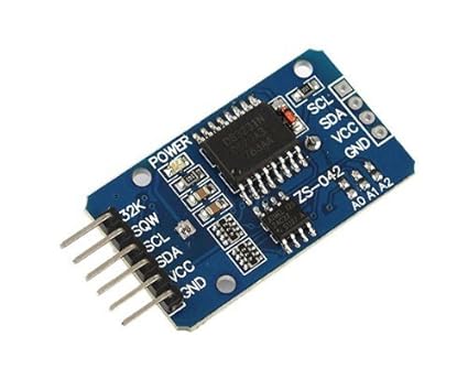

I'm using the new DS3231 RTC it is supposed to be more accurate and it works great with the DS1307 library, no changes necessary...connections are all the same as well

Simone, You can use any model of RTC without any other I2C device on board.
Henning's library NOT support 2 or more I2C devices on same channel like this model:
Here a model that you can use:
Real Time Clock Module
Willie, this model work with Henning's library also?

Thank you both. Now I understand why my "tiny Rtc I2C" module didn't work.
