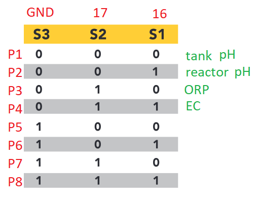

I'm testing the pcf8575, the temperature sensor circuit, the webcontrol, the level sensors and everything works very well. But I have a big doubt for the atlas scientific multiplexer.
The circuit you show is for the old pcb and the new one requires an extra pin (s1, s2, s3). Is it compatible with ferduino?

Connect according for this table:
S1 to 16
S2 to 17
S3 to GND
P1 to tank pH
P2 to Reactor pH
p3 to ORP
p4 to EC
