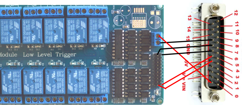

The connection scheme that I have swiped is the following:
As I was saying, the relay control LEDs (D1 ... D16) flash if, for example, I use a timer ...
Post Number:#3 Post Thu Nov 08, 2018 6:48 pm
As I told here 5V pin in this relay board is an output.
Check the wiring on video.

If your relay board is like this picture it should work with 5 V and not 12 V. Check the silk screen on relay. This model haven't a LM2576S to drop the voltage to 5 V.
So you should connect 5 V power supply to terminal block. Maybe your relays were damaged by 12 V power supply.

I can see in this picture green and white wires connected to 5V pin. You can't connect 5 V from Arduino to 5V from relay board.
Also check if has continuity between GND pin and GND on terminal block in relay board. Otherwise connect it together.
