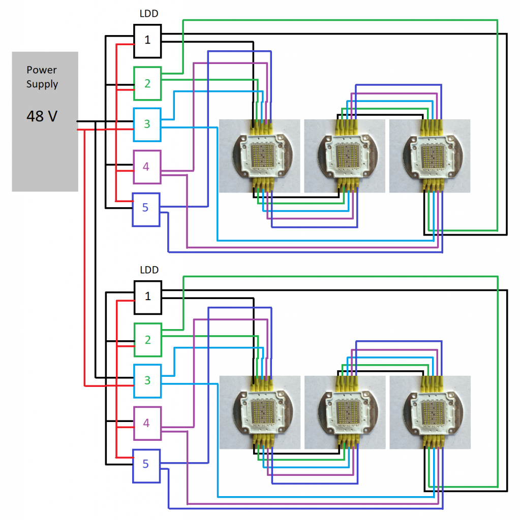

The intention is to mount the lighting with 6 multichip plates with the following characteristics
CHANNEL 1: 5 Cree XTE Royal Blue 15V @ 350-1500mA LDD 1000H
CHANNEL 2: 5 Cree XPE2 Blue 15V @ 350-1000mA 700H
CHANNEL 3: 3 Creed XTE 6500K + 2 Cree 5000K 15V @ 350-1500mA LDD 1000H
CHANNEL 4: 5 SemiLED UV 420nm 15V @ 350-1000mA 700H
CHANNEL 5: 5 Cree XTE Royal Blue 15V @ 350-1500mA 1000H
I have a great ignorance in electronics and after informing myself I think that this solution could be valid.
I plan to use the following drivers on a 5 channel PCB
CHANNEL 1: LDD 1000H
CHANNEL 2: 700H
CHANNEL 3: 3 LDD 1000H
CHANNEL 4: 5 700H
CHANNEL 5: 1000H
They are suitable?
Based on the following calculations I think that for 6 multichip plates I will need 2 groups of 3
Assuming the use of 48V power supply (45V when using LDD-H)
15 * 3 = 45 V (3 multichip boards maximum).
So I will need 2 5 channel PCB
Rough estimate of the power required for the 48V power supply
Sum by controllers used:
1000 + 700 + 1000 + 700 + 1000 = 4,400 mA
4.4 A x 48 V = 211 W
It would really be:
(45V + 3V) x 1 A = 48 W
(45V + 3V) x 0.7 A = 33.6 W
So the power supply needed to control 3 multichip boards would be:
48 V
4.4 A
211.2 W
As a summary you would need:
6x multichip LED board
2x 5-channel PCB (2 LDD 700H and 3 LDD 1000H on each PCB)
2x Power supply (48V, 4.4A, 211.2W)
Is the configuration correct?
On the other hand, for the independent control of each channel it would simply be to connect channel to channel on both PCBs?
I don't know if it's all too tight, is there a better solution?
Thank you very much
PS: maybe you should join with the previous post
Post Number:#6 Post Sun Oct 25, 2020 1:40 pm
According to my understanding you are talking about something like this:
It seems ok to me but as I told before for the channel with max. current of 1500 mA the LDD 1200 should be better because 300 mA is enough safety margin.
The part list could be.
6 x 100w multichip LED
2 x 5-channel PCB
6 x LDD-1200-H
4 x LDD-700-H
1 X 750 W / 15.7 A / 48 V power supply.
