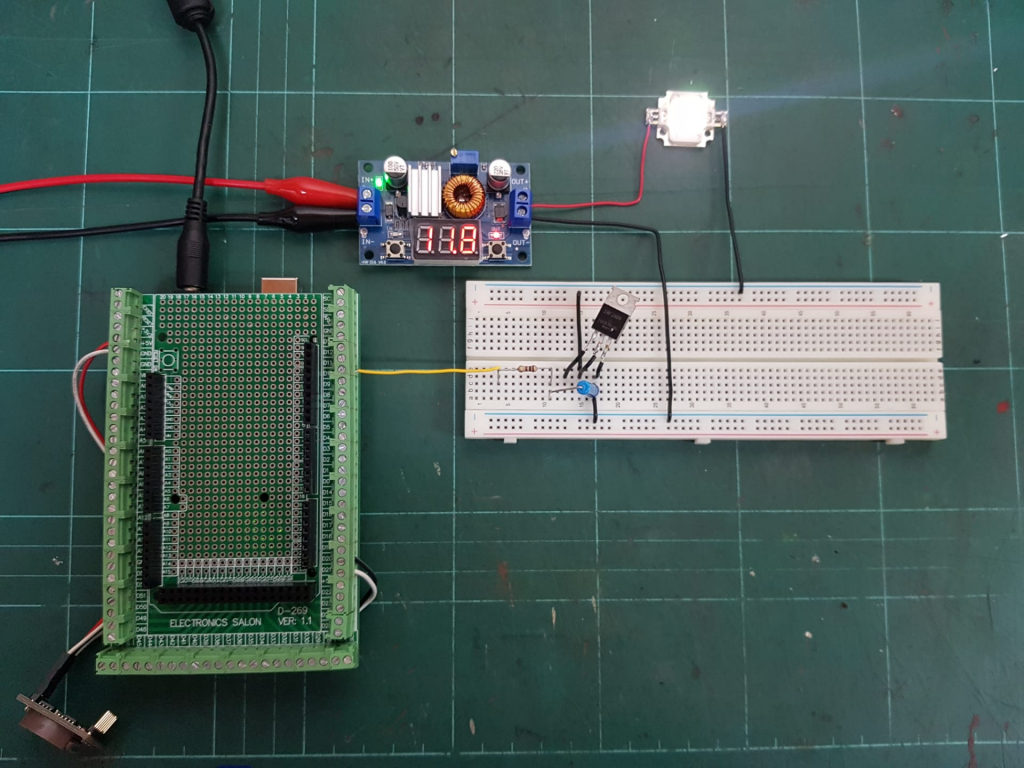

Hi Fernando,
Can you help me,
What is wrong with this?
I can't dimme the led via PWM, and I dont know why.
Regards,
Ricardo Viegas
Post Number:#2 Post Fri Feb 07, 2020 11:06 am
Welcome Ricardo!
Connect GND from Arduino to GND from 12 V power supply.

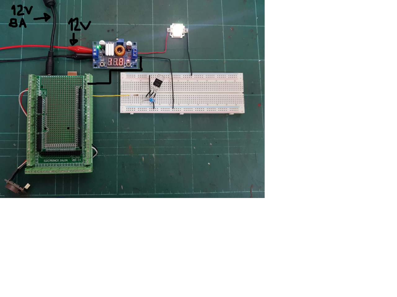

Hi Fernando,
You mean like this:
Regards,
Post Number:#4 Post Sun Feb 09, 2020 12:21 pm
Yes, but you can connect in breadboard side.
