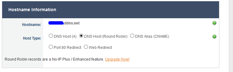

This seems a problem with No-IP. I can't make it work with http://ping.eu/port-chk/ too.
The port is always closed.
-------------------------------- Last edited Fri Mar 06, 2015 9:07 pm --------------------------------
Now is working with this configuration. :)

Image: http://ferduino.com/forum/gallery/image.php?album_id=11&image_id=308
I cant get round robin to save on noip, but have tried (A) again and its now working :-bd
No idea why it wasnt working last night but happy nevertheless.
