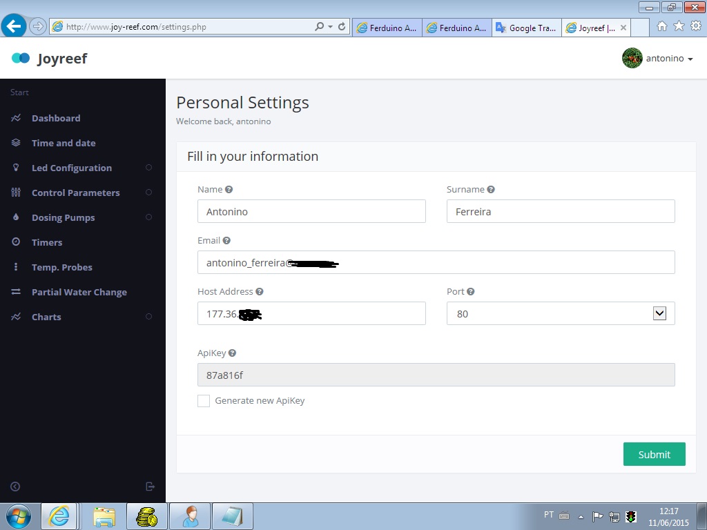

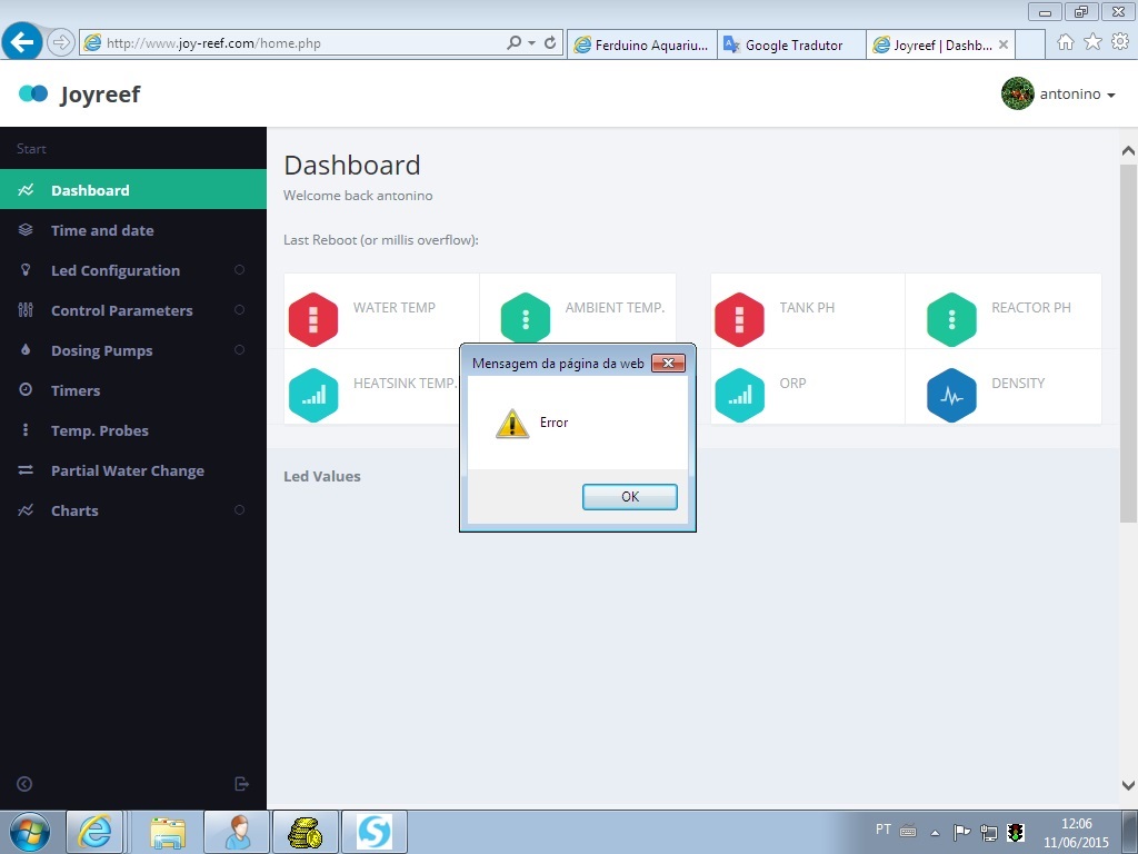

Hello, I made all Topic procedures http://www.ferduino.com/forum/viewtopic.php?f=8&t=34, as far as I place
http: // local_ip: port / cmd = password_in_base64,0, K works, presents all the information but when I open the joy-reef presents an error message.
I appreciate the help

Hello Fernando, still can not open another door, I tried 5000, 8080, when I check in http://ping.eu/port-chk/ the door is closed. How do I open another door? My router is an airport express.
Now in joyreef displays the message: Error connecting, please check settings

Hello, so far I could not make it work. Already I switched port, already changed the apikey and so far nothing.
When I check the external IP on the site http://ping.eu/port-chk/ only port 80 is open, I do not know if there's anything more to do.
