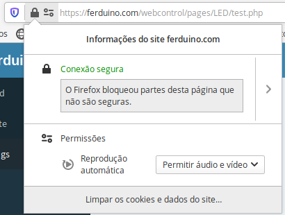

It's because the browser is blocking mixed content since the web interface has SSL.
In top bar click on lock icon and allow unsecure content.

Can you check if your camera allows HTTPS please?
There's some model (page 7) from Foscam that allows.
If possible open the port 443 instead 88.
