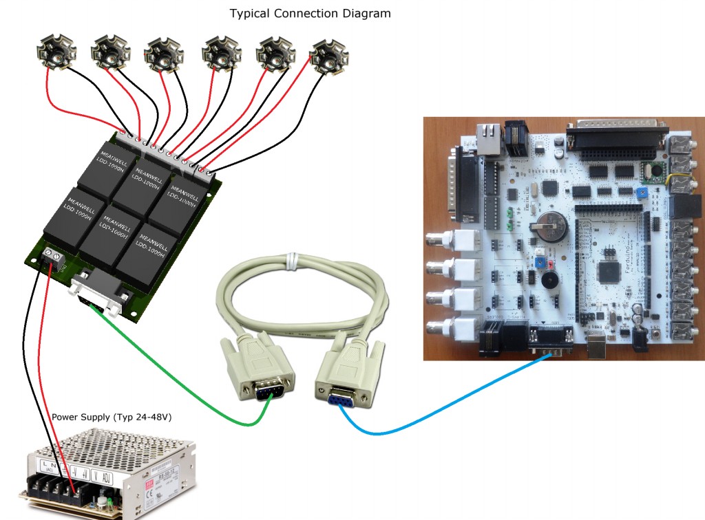

To use the leds with ferduino I would need a board like that?
Last edited by Fernando Garcia on Mon Jan 26, 2015 1:59 am, edited 1 time in total.
Reason: Image replaced. Spelling corrected.
Post Number:#6 Post Mon Jan 26, 2015 2:00 am
Yes, you can find some free projects here.

Fernando, only tells me one thing start now (I must be teasing you very much) the link would look like this:
source> LED> db9 driver> DB9 ferduino> source?

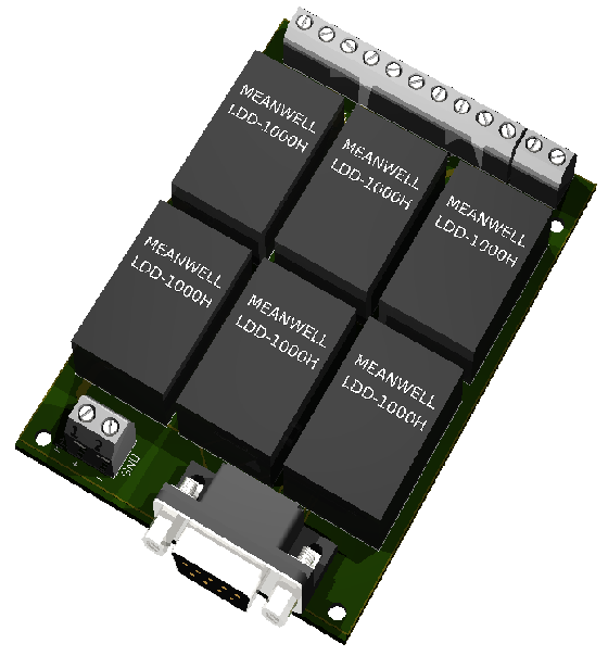

I searched for a driver board equal to that with DB9 and not found, u know where is? or I'll have to do?
Post Number:#12 Post Wed Jan 28, 2015 4:32 pm
This module isn't available for now.
You can use something like this to connect wires on terminal block.
