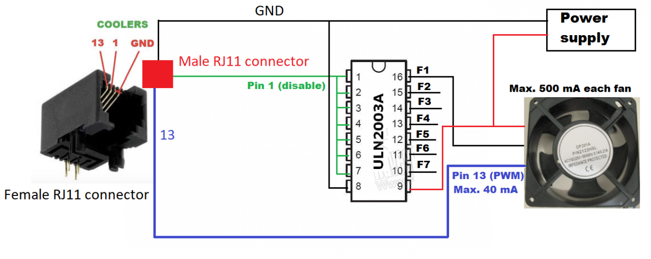

Hi guys,
I saw the circuit scheme for connecting fans here:
viewtopic.php?f=24&t=40
and I saw the pins scheme of Ferduino here:
http://ferduino.com/wp-content/uploads/ ... PinMap.pdf
I would like to connect, for cooling the heatsink, 2 fans like this:
https://www.amazon.it/gp/product/B002KT ... JU7H&psc=1
using a cable like this:
https://www.amazon.it/gp/product/B001J2 ... JU7H&psc=1
and obviously the rj11 connection on my Ferduino Mega...but I'm not able to understand how.
I understood how to connect GND and Pin 13...but what about 12v from power supply? straight to the fan? and the GND from power supply?
Sorry for my ignorance. I'm learning a lot with this project.
Thank you so much.
Post Number:#2 Post Sat Nov 25, 2017 9:00 pm
It's exactly as you can see here:
I don't think this cable useful for this circuit.

Hi Fernando!
I'm sorry, maybe I was not able to explain myself in the right way.
On Ferduino mega you put this connector with this scheme:
On the basis of the previous post I think that you connected the RJ11 like here:
Is it correct?
But the power supply should be different and separated from the Ferduino one, right?
so how you thought to connect the power supply to pin 9 of the ULN2003A? I don't think you will suggest to solder a cable under the board...
Furthermore on Ferduino Mega we have 3 ULN2003, as I can see from this picture:
http://ferduino.com/wp-content/uploads/ ... a-2560.pdf
Which one you are referring to?
Thank you a lot Fernando.
Last edited by Fernando Garcia on Sun Nov 26, 2017 10:09 pm, edited 1 time in total.
Reason: Please use tags [img=left][/img] to post images here.
Your are doing a mess.
It's a separated circuit, this ULN is not available in Ferduino Mega.
You will connect this circuit to your board just using a male connector.

Now is far more clear Fernando. Thank you!
Just a final clarification: can I use only pin 13 and avoid to connect the pin 1?
Post Number:#6 Post Mon Nov 27, 2017 6:38 am
Your cooler will stays always ON in minimum speed.
Post Number:#7 Post Mon Nov 27, 2017 8:48 am
Posts: 50
Topics: 13
Joined: Wed Sep 06, 2017 7:45 pm
Topics: 13
Italy
So the answer is not. Got it
