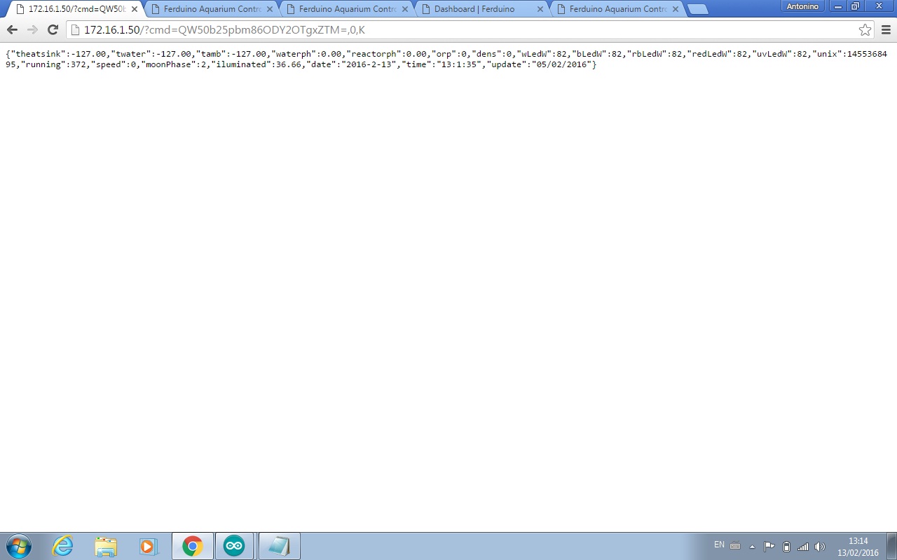

Show me a print screen of your browser using local IP to see if something is wrong.

Presents no socket:

Post Number:#4 Post Sat Feb 13, 2016 1:56 pm
The Json format is right.
There other server replying the requests, I can see this answer:
string(45) "
It works!
Try the port 5000 because the 80 is blocked by many providers.

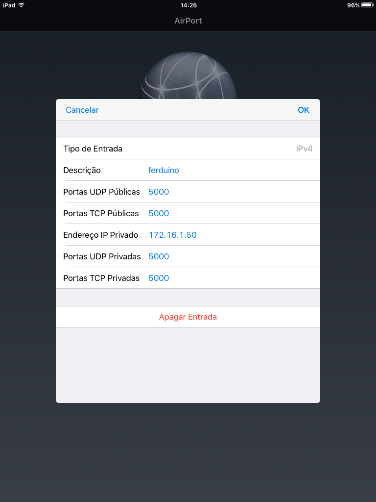

Post Number:#8 Post Sat Feb 13, 2016 9:02 pm
The problem is on port forwarding in your router.
Can you show a print screen of the settings in your router?

Hi Fernando, my router is an apple airport extreme, that is the port setting configuration. If this router does not work, which the router to recommend?

Post Number:#10 Post Sun Feb 14, 2016 3:07 pm
Firstly you should check with your provider to know if the ports are not blocked.

Ready friend, problem solved, lacked release the door in internet server. Now it is working 100%.
