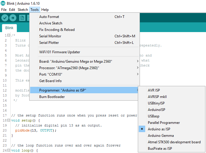

After get some experience using AVRDUDESS you can try send the code directly from IDE but this way sometimes fails and it is hard to debug.
1 - Select Arduino as ISP:
2 - Upload using this option:
