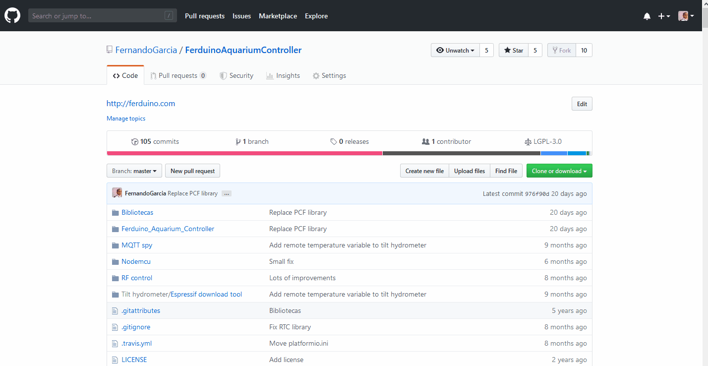

Post Number:#6 Post Sat Jun 08, 2019 10:02 am
You can browse the repository on Github and download the code from specific point but it will be missing features and fixes.

Post Number:#8 Post Sat Jun 08, 2019 2:10 pm
As I told old version can be missing fixes.
Apply this fix.
https://github.com/FernandoGarcia/Ferdu ... dcfd3a2127
I won't help you with more problems in regression.
The initial issue was answered so I'll close this topic.
