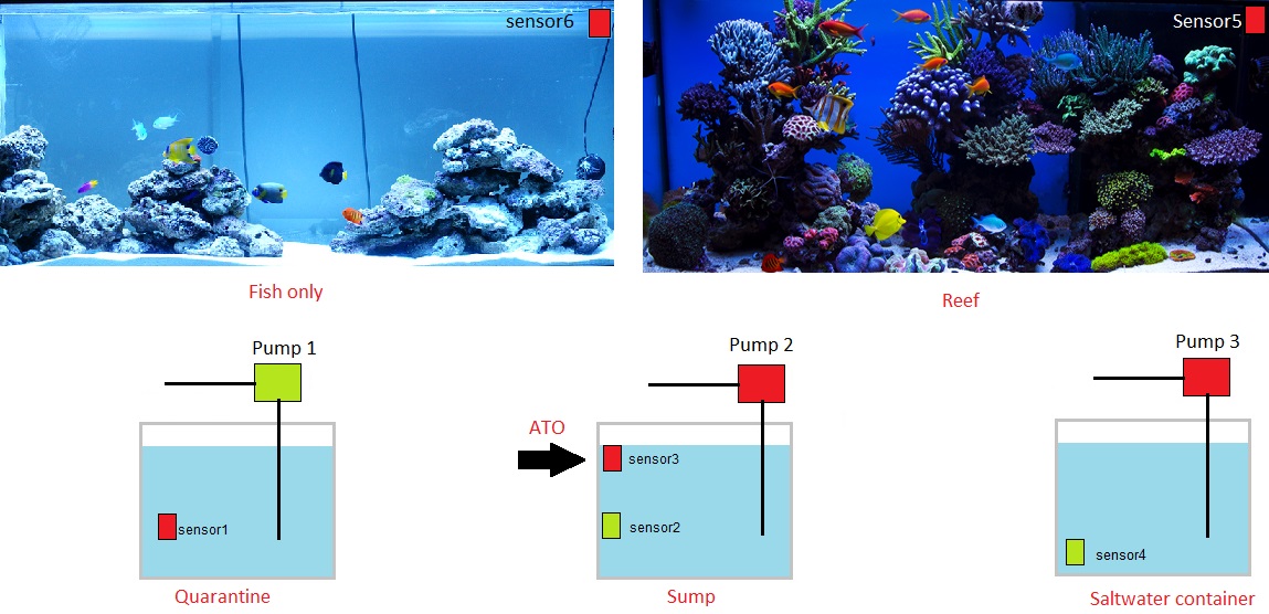

Post Number:#2 Post Fri Nov 06, 2015 11:58 am
In fact the comments should have some particularity of Willie's system.
My comments haven't anything related with ATO function.
All comments are related to my system and can be different from others users. Each user should adjust according to your system.
Maybe this schematic can explain better my system.
Fish only = Tank without corals.
This comments are acceptable but, makes no sense in portuguese. :)
const int sensor1 = A0;    // QUARANTINE WATER CHANGE, BOTTOM LEVEL TRIGGER (STOPS QUARANTINE PUMP-OUT)
const int sensor2 = A1;    // SUMP WATER CHANGE, BOTTOM LEVEL TRIGGER (STOPS SUMP PUMP-OUT)
const int sensor3 = A2;    // SUMP WATER CHANGE, TOP LEVEL TRIGGER (STOPS SUMP PUMP-IN)
const int sensor4 = A3;    // SALTWATER RESERVOIR LOW/EMPTY WARNING - (ALERT WHEN SALTWATER RESERVOIR GETTING LOW/EMPTY)
For sensors 5 and 6 it should be better:
const int sensor5 = A4;    // REEF TANK TOP LEVEL - WARNING TRIGGER FOR WATER LEAK
const int sensor6 = A5;    // FISH ONLY TANK TOP LEVEL - WARNING TRIGGER FOR WATER LEAK
"sensor3" is used too for ATO function and the pump or solenoid to fill the sump is activated by "solenoide1Pin".
Regarding circuit, should be like this:
