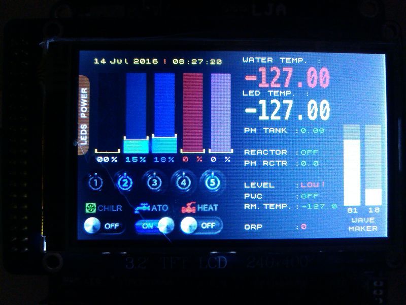

This is the first time I tried arduino program, because I was busy lately loose I tried to learn to understand the program code for arduino, ferduino and try Jarduino I browse line by line, and there is little enlightenment.
begins with a question link here: RAW To Ferduino
by not changing the function of ferduino, I tried to redesign the mainscreen, there is little function that I hide in mainscreen because I do not need.
This is mainscreen looks:
1. Using a font of rinky dink Here links http://www.rinkydinkelectronics.com/r_fonts.php. I outlined to water temperature display and LED.
2. Icon from iAqua Iaqua Planted Forum
3. I want to show a graph WaveMaker in mainscreen, because it seemed alive, here I find a difficult problem, This graphic up and down does not work perfectly, not like in wavemaker Tab.
fernando, i hopefully can help solve my problem. :ympray:
I add the last line of code WaveMaker. copypaste from WaveMaker tab, if this is correct?

  if ((violetaLed != uvled_out) || refreshAll)      // Atualiza gráfico led violeta
    violetaLed = uvled_out;
    ledLevel = LedToPercent(uvled_out);
    myGLCD.setColor(0, 0, 0);
    myGLCD.fillRect(128, 192, 185, 204);      // Apaga potência anterior
    myGLCD.setColor(cor_canal5[0], cor_canal5[1], cor_canal5[2]);
    strcpy_P(buffer, (char*)pgm_read_word_near(&(nome_canal[5])));
    myGLCD.print(buffer, 128, 192); // nome_canal[5] = "VIO"
    offset = map(ledLevel, 100, 0, 28, 137);
    myGLCD.print(":", 152, 192);
    myGLCD.fillRect(163, offset, 183, 137);
    myGLCD.print(String(ledLevel), 160, 192);
    myGLCD.print("%", 186, 192);
    myGLCD.fillRect(163, offset - 1, 183, 27);       // Apaga barra anterior
//  myGLCD.fillRect(313, 14, 353, 26);                // Apagar temperatura dissipador
//  myGLCD.fillRect(303, 32, 320, 40);                // Apagar temperatura agua
//  myGLCD.fillRect(324, 42, 390, 54);                // Apagar PH do aquario
//  myGLCD.fillRect(318, 56, 390, 68);                // Apagar PH do reator
     myGLCD.fillRect(310, 98, 300, 110);               // Apagar noticia de chiller ligado/desligado
//  myGLCD.fillRect(289, 112, 350, 124);              // Apagar noticia de aquecedor ligado/desligado
//  myGLCD.fillRect(270, 126, 320, 138);              // Apagar noticia de reator ligado/desligado
    myGLCD.fillRect(280, 154, 310, 166);              // Apagar noticia de reposicao ligado/desligado
    myGLCD.fillRect(280, 168, 310, 180);              // Apagar noticia de nivel normal/anormal
//  myGLCD.fillRect(310, 5, 375, 70);    //moon 310, 5, 65, 65,
//  myGLCD.fillRect(250, 182, 365, 193);              // Apagar noticia de TPA ligado/desligado
 // myGLCD.fillRect(312, 195, 360, 207);              // Apaga consumo de energia
  myGLCD.fillRect(80, 144, 110, 156);              // Apagar noticia de Timers 1 ligado/desligado
  myGLCD.fillRect(80, 156, 110, 168);              // Apagar noticia de Timers 2 ligado/desligado
  myGLCD.fillRect(80, 168, 110, 180);              // Apagar noticia de Timers 3 ligado/desligado
  myGLCD.fillRect(80, 180, 110, 192);              // Apagar noticia de Timers 4 ligado/desligado
  myGLCD.fillRect(80, 192, 110, 204);              // Apagar noticia de Timers 5 ligado/desligado
  myFiles.loadBitmap(296, 20, 14, 12, "c.raw"); //celcius indicator
  myFiles.loadBitmap(296, 60, 14, 12, "c.raw"); //celcius indicator
  myGLCD.setColor(0, 255, 0);  //HASIL MONITOR
//  myGLCD.printNumF(tempH, 2, 310, 14);   // heatsink
  myGLCD.printNumF(PHA, 2, 285, 98);     // PH aqua  myGLCD.printNumF(PHA, 2, 285, 42);
  myGLCD.printNumF(PHR, 1, 285, 140);    // PH reator
  myGLCD.printNumF(tempA, 1, 285, 195);  // Temperatura Room //myGLCD.printNumF(tempA, 1, 285, 195);
//====================================================temperature
   myGLCD.setColor(180, 255, 0);
   myGLCD.setFont(GroteskBold16x32);
   myGLCD.printNumF(tempH, 2, 212, 60);   // heatsink
   myGLCD.setColor(255, 11, 250);
   myGLCD.printNumF(tempC, 2, 212, 18);   // Temperatura da agua //myGLCD.printNumF(tempC, 2, 302, 28);   // Temperatura da agua
   myGLCD.setColor(255, 0, 0);
  if (bitRead(status_parametros,2)==true)
    myGLCD.printNumF( tempC, 2, 212, 18);     // Temperatura em vermelho
//========================fonts normal/ lagi=========================================
   myGLCD.setFont(RusFont1);
  if (bitRead(status_parametros,3) == true)
    myGLCD.printNumF(PHA, 1, 285, 42);       // PH do aquario em vermelho
  if (bitRead(status_parametros,6) == true)
    myGLCD.printNumF(PHR, 1, 285, 140);       // PH do reator em vermelho
  if (bitRead(status_parametros,0) == true)
   // myGLCD.setColor(0, 130, 255);
   // myGLCD.print("ON", 285, 98);     // Chiller ligado
    myFiles.loadBitmap(212, 213, 24, 24, "1circN.raw");
  else
    //myGLCD.setColor(0, 255, 0);
   // myGLCD.print("OF", 285, 98);          // Chiller desligado
    myFiles.loadBitmap(212, 213, 24, 24, "1circF.raw");
  if (bitRead(status_parametros,1) == true)
    myGLCD.print("ON", 285, 112);           // Aquecedor ligado
  else
    myGLCD.print("OFF", 285, 112);          // Aquecedor desligado
  if (bitRead(status_parametros,5)== true)
    myGLCD.print("ON", 285, 126);           // Reator ligado
  else
    myGLCD.print("OFF", 285, 126);          // Reator desligado
  if (bitRead(Status,1) == true)
    myGLCD.print("ON", 285, 154);           // Reposição ligada
  else
    myGLCD.print("OFF", 285, 154);          // Reposição desligada
  if (nivel_status==true)
    strcpy_P(buffer, (char*)pgm_read_word_near(&(tabela_textos[196])));
    myGLCD.print(buffer, 285, 168);         // Nivel baixo em vermelho // tabela_textos[196] = "BAIXO!"
  else
    strcpy_P(buffer, (char*)pgm_read_word_near(&(tabela_textos[197])));
    myGLCD.print(buffer, 285, 168);          // Nível nornal // tabela_textos[197] = "NORMAL"
  if ((bitRead(tpa_status,1)== true) && (bitRead(tpa_status,2)== false))
    myGLCD.print("ON", 285, 182);           // TPA em andamento
  else if ((bitRead(tpa_status,1) == false) && (bitRead(tpa_status,2) == false))
    myGLCD.print("OFF", 285, 182);           // TPA não esta em andamento
  if (bitRead(tpa_status,2) == true)
    strcpy_P(buffer, (char*)pgm_read_word_near(&(tabela_textos[86])));
    myGLCD.print(buffer, 285, 182);          // Sinaliza falha durante uma TPA // tabela_textos[86] = "FALHA!"
  if (bitRead(temporizador_status,1) == true)
    myGLCD.print("ON", 80, 144);           // Timer 1 ligado
  else
    myGLCD.print("OFF", 80, 144);          // Timer 1 desligado
  if (bitRead(temporizador_status,2) == true)
    myGLCD.print("ON", 80, 156);           // Timer 2 ligado
  else
    myGLCD.print("OFF", 80, 156);          // Timer 2 desligado
  if (bitRead(temporizador_status,3) == true)
    myGLCD.print("ON", 80, 168);           // Timer 3 ligado
  else
    myGLCD.print("OFF", 80, 168);          // Timer 3 desligado
  if (bitRead(temporizador_status,4) == true)
    myGLCD.print("ON", 80, 180);           // Timer 4 ligado
  else
    myGLCD.print("OFF", 80, 180);          // Timer 4 desligado
  if (bitRead(temporizador_status,5) == true)
    myGLCD.print("ON", 80, 192);           // Timer 5 ligado
  else
    myGLCD.print("OFF", 80, 192);          // Timer 5 desligado
  if(temperatura_alta == true)
   strcpy_P(buffer, (char*)pgm_read_word_near(&(tabela_textos[236])));//HIGH TEMPERATURE!
   myGLCD.print(buffer, 58, 90);          // Alerta de temperatura alta para os LEDS.
  if(temperatura_baixou == true)
    strcpy_P(buffer, (char*)pgm_read_word_near(&(tabela_textos[237]))); // "TEMP. BAIXOU!"
    myGLCD.print(buffer, 58, 90);          // Alerta de que a temperatura esteve alta para os LEDS.
  //=======================================wavemaker
  int Pump1PWM_t;
  int Pump2PWM_t;
  int bar = map(Pump1PWM, 0, 255, 198, 97);
  if (bar < 97 )
    bar = 97;
  if (bar > 198)
    bar = 198;
  int bar2 = map(Pump2PWM, 0, 255, 198, 97);
  if (bar2 < 97)
    bar2 = 97;
  if (bar2 > 198)
    bar2 = 198;
  Pump1PWM_t = map(Pump1PWM, 0, 255, 0, 100);
  Pump2PWM_t = map(Pump2PWM, 0, 255, 0, 100);
  myGLCD.setBackColor(0, 0, 0);
  myGLCD.fillRect(341, bar - 1, 362, 91);
  myGLCD.fillRect(370, bar2 - 1, 391, 91);
  myGLCD.setColor(0, 0, 255);
  myGLCD.fillRect(341, 198, 362, bar);
  myGLCD.fillRect(370, 198, 391, bar2);
  myGLCD.setColor(180, 180, 180);
  myGLCD.drawRect(341, 92, 362, 198); //rect wavemaker
  myGLCD.drawRect(370, 92, 391, 198); //rect wavemaker2
  if(Pump1PWM_t < 10)
    myGLCD.setColor(255, 255, 255);
    myGLCD.printNumI(Pump1PWM_t, 256+90, 200);
    myGLCD.print("  ", 264+90, 200);
  else if ((Pump1PWM_t >= 10) && (Pump1PWM_t <= 99))
    myGLCD.print(" ", 272+90, 200);
  else
  if(Pump2PWM_t < 10)
    myGLCD.printNumI(Pump2PWM_t, 285+90, 200);
    myGLCD.print("   ", 293+90, 200);
  else if((Pump2PWM_t >= 10) && (Pump2PWM_t <= 99))
    myGLCD.print(" ", 301+90, 200);
  else

Hi Diztly!
I like to see user trying to make your own things. :)
There a small problem because the main screen is updated to each 5 seconds. So the graph won't work very well.
The best option is to create a new function like "void mainScreen_waveGraph()" in the tab "botoes_e_etc" or a new tab.
  int Pump1PWM_t;
  int Pump2PWM_t;
  if (bar < 97 )
    bar = 97;
  if (bar > 198)
    bar = 198;
  if (bar2 < 97)
    bar2 = 97;
  if (bar2 > 198)
    bar2 = 198;
  if(Pump1PWM_t < 10)
  else
  if(Pump2PWM_t < 10)
  else
Then on loop call the function on this way:
if(dispScreen == 0)
  mainScreen_waveGraph();
BTW: Again you don't told me what's the problem exactly.
It can be many things!

Now the bargraph is working properly, but every 6 seconds the bar paused for a moment, whether this problem can be resolved ? even if it can not be resolved, it is already very good.

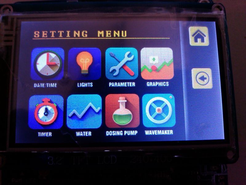

where did you get the icons to do the menu ??
thank you
you can find google images for free usage
Google Flat Icon
this my icon
