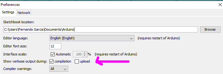

If this warnings are bothering you, go to file > preferences and uncheck this options.
