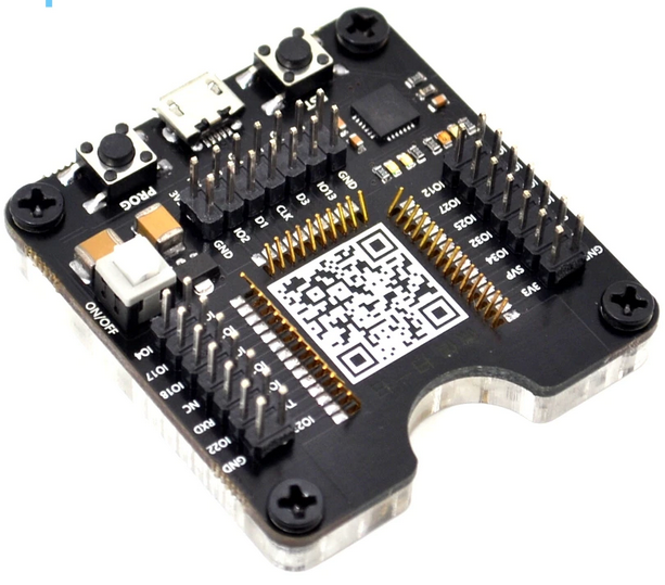

What's the reason to use ESP8266 12F instead NodeMCU? Are you doing a custom board?
The "experiment board" you are talking about is like this?
Image: https://www.ferduino.com/forum/gallery/image.php?album_id=11&image_id=744
I thought that the nodemcu were the same as esp8266 12f for the plate experience
Last edited by Fernando Garcia on Tue May 04, 2021 10:11 am, edited 1 time in total.
Reason: Please post images using tags [img=left]URL[/img].
Post Number:#8 Post Tue May 04, 2021 10:21 am
ESP8266 12F is the microcontroller used on NodeMCU.
This "experience plate" is more known as breadboard or protoboard. ;)
