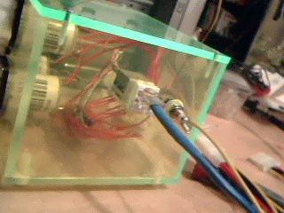

Yes I have a female RJ45 on my dosing pump box and made a cable to connect, plus line to bring 12 volt to dosing pump.

Hi Fernando, I was wondering if I could use a data logging shield for sd card in stead of tft as I want to make a small enclosure for the display. :-?

four dosing pump setup will eventually be 6 pumps.
