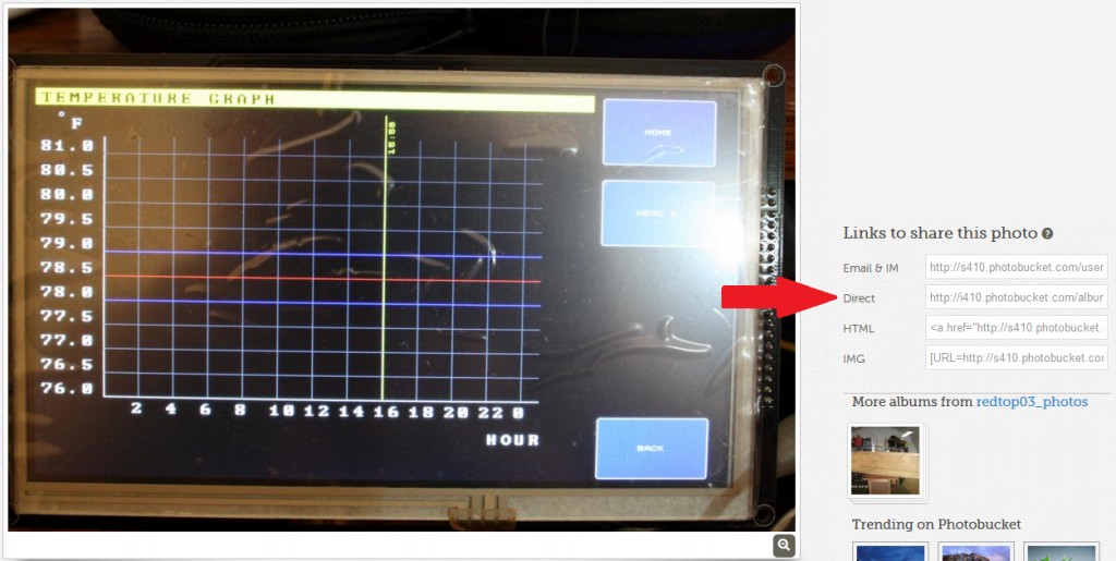

Post Number:#31 Post Sun Jun 01, 2014 5:24 pm

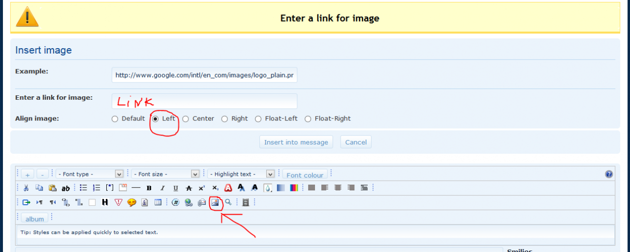

Willie you're using the link wrong.
Use the "direct" link on photobucket.
Also use this tool to insert the image here.
This is the original size of your image.

OK thanks, I was using the IMG code and directly posting to the forum, that's how I always do it everywhere else, I'm still getting used to this forum but I like all the options :)
Post Number:#33 Post Sun Jun 01, 2014 5:50 pm
If you use only the tag [IMG] the maximum size will be 800 x 600 pixels.
If you use the tag [IMG=LEFT] the maximum size will be 1280 x 1024 pixels.
:-bd
