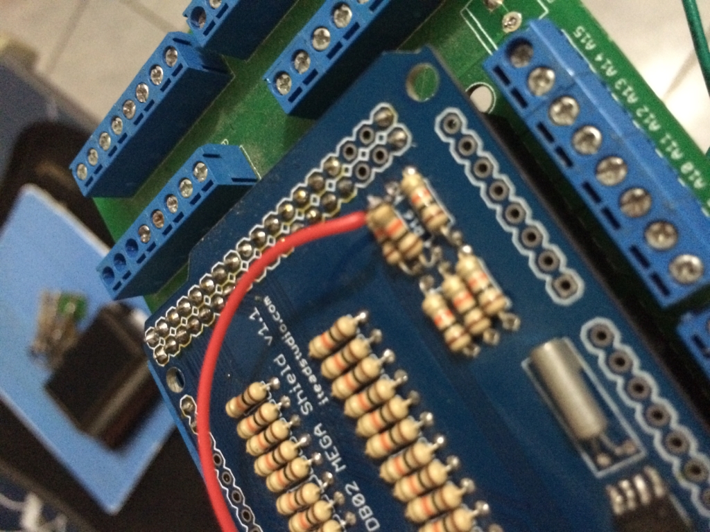

follow screens of module and bridge:
Shiel with bridge:
Module:
Post Number:#10 Post Fri Aug 07, 2015 1:27 pm
Look for this:
Apparently you have a short circuit between pin 4 and 53.

I verified now, and dont have a short circuit but however climbed over the resistor as you can see in the picture, but still not worked.

The bridge on p53 is in a resistor or In a hole after resistor ?
Post Number:#13 Post Fri Aug 07, 2015 7:10 pm
Connect the pin 53 only on W5100.
The bridge is between pin 4 and R16 only.
Post Number:#14 Post Fri Aug 07, 2015 7:27 pm
Posts: 45
Topics: 9
Joined: Thu Apr 10, 2014 12:21 pm
Topics: 9
I do not understand, do a test with p53 in module and without the bridge?
Post Number:#15 Post Fri Aug 07, 2015 7:36 pm
The bridge is the "chip select" for SD card no more.
Keep the bridge otherwise will have conflict between SD and W5100 because by default this two devices use the pin 53 to "chip select".
Make sure that haven't short circuit between pin 53 and R16.
