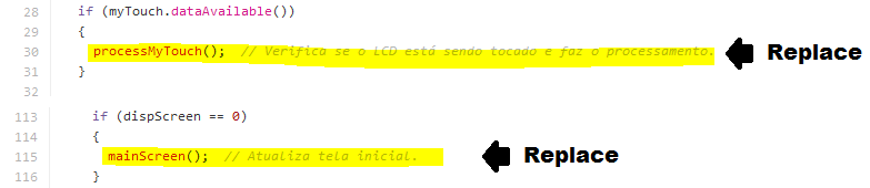

Post Number:#11 Post Fri Nov 14, 2014 4:23 pm
I hate give the fish.
I prefer teach get the fish.
But I think that's missing some willingness to learn.
Anyway here's your code:
In the tab "Ferduino" find:
extern uint8_t BigFont[];
Add after:
extern uint8_t SevenSegNumFontPlus[];
Find:
int dispScreen = 0;
Add after:
unsigned long previousMillis_2 = 0;
int interval = 20; // In seconds
In the tab "botoes e etc" add:
void clockScreen()
  myGLCD.clrScr();
  myGLCD.setFont(SevenSegNumFontPlus);
  myGLCD.setColor(0, 174, 255);
  myGLCD.print(rtc.getTimeStr(FORMAT_LONG), CENTER, 100);
On loop find:
processMyTouch();
Replace with:
    if(((millis() - previousMillis_2) > interval * 1000) && (dispScreen == 0))
      clearScreen();
      mainScreen(true);
    else
      processMyTouch();
    previousMillis_2 = millis();
Find:
mainScreen();
Replace with:
      if((millis() - previousMillis_2) > interval * 1000)
        clockScreen();
      else
        mainScreen();

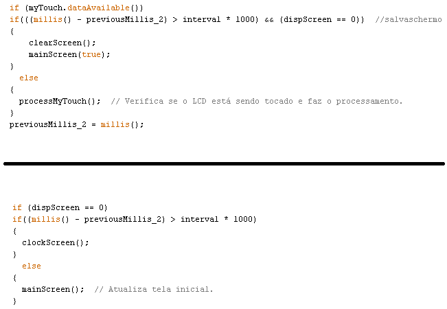

Post Number:#13 Post Sun Nov 16, 2014 8:04 am
Are you sure?
Watch on youtube.com

Post Number:#15 Post Sun Nov 16, 2014 10:38 am
It's ok?
Where I told for you remove "{}"?

Post Number:#17 Post Sun Nov 16, 2014 10:58 am

Post Number:#19 Post Sun Nov 16, 2014 5:03 pm
Posts: 27
Images: 1
Solve rating: 1
Joined: Wed May 07, 2014 3:20 pm
Age: 48
Italy
[ITA]
Simone, non può essere :D
quel valore può essere un intero qualsiasi, quindi non può cambiare se metti 20 o 35.
Cerca il problema da qualche altra parte!
[/ITA]
It can't be... search for the problem somewhere else!
[ITA]
devi aggiugnere una { ( parentesi graffa aperta ) dopo
if(myTouch.dataAvaiable())
e dopo
if ( dispScreen ==0 )
e una } (parentesi graffa chiusa ) dopo
previousMillis_2= millis();
e dopo
mainScreen();
