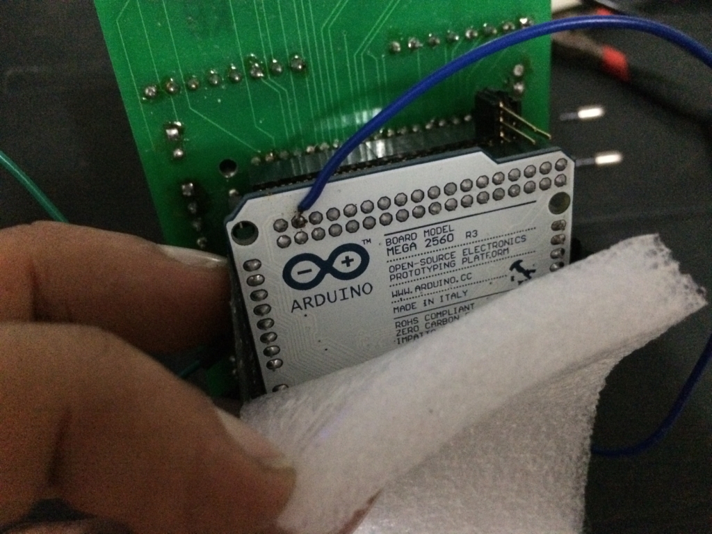

The following pictures of how I made the connections, the LCD is on the password screen and the touch is not working.

Are you using this line on code?
UTouch      myTouch(6,5,4,3,2);

Fernando, I made the change in code, which is only now appearing to "Please insert the SD CARD" message. What can be now?
When the code is uTouch myTouch (7,6,5,4,3); , The touch does not work and is on the password screen, when I change to uTouch myTouch (6,5,4,3,2); is requesting the card.
I put the memory card in both the LCD and in the ethernet shield W5100.
What can be now?
Thank you.
Use this line:
const byte ChipSelect_SD = 4;
