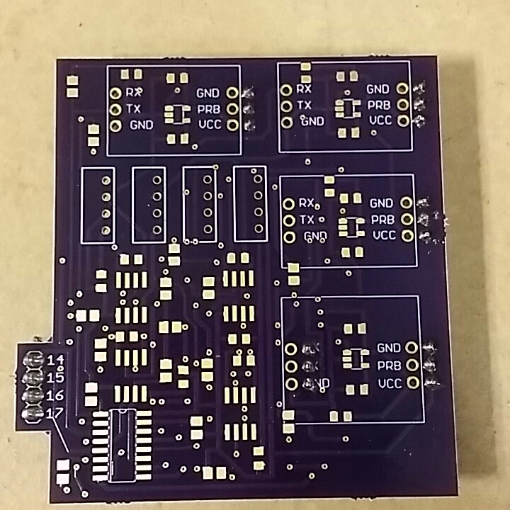

new ISO board build, designed by Fernando.
Board printed by OSHpark.com.
Board built by Christopher Kindig. (with help) ;)
It connects to the stamps and pins 14,15,16,17 to isolate power to each stamp and make the readings stable.
More common used when using EC probe.
-------------------------------- Last edited Wed Dec 02, 2015 10:31 pm --------------------------------
Building the ISO one circuit at a time and test as I go.
-------------------------------- Last edited Wed Dec 02, 2015 10:33 pm --------------------------------
Completed ISO circuit running on my system.

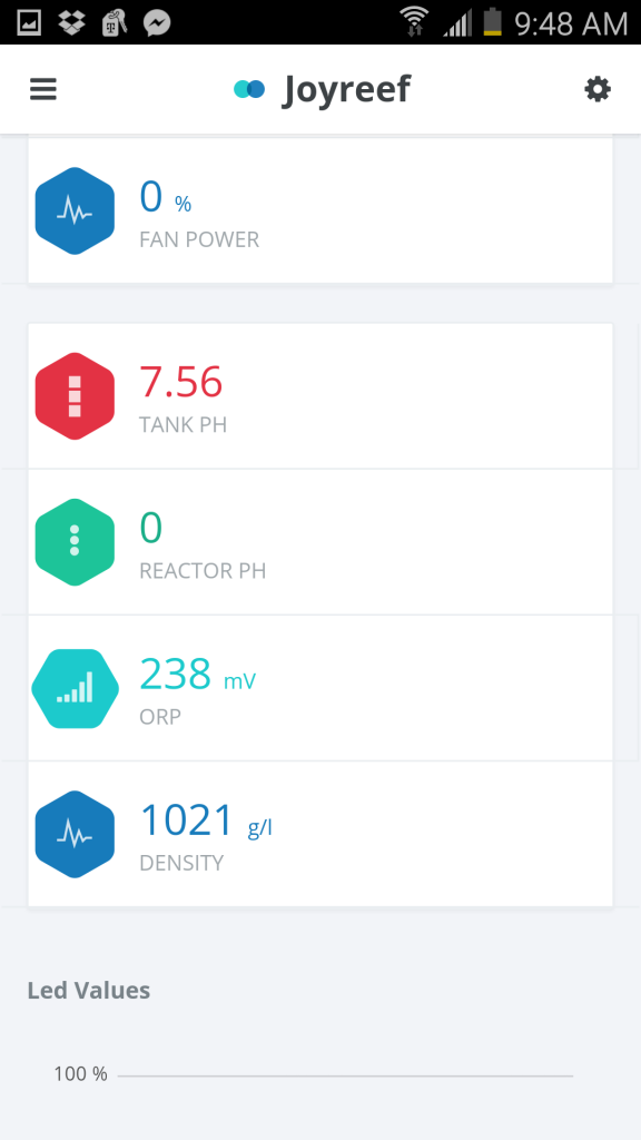

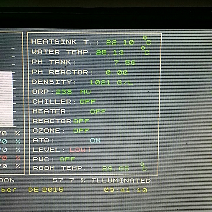

screen on controller showing new readings for ISO, Ph, ORP and Specific gravity all stable and correct.
-------------------------------- Last edited Wed Dec 02, 2015 10:39 pm --------------------------------
Joy reef screen shot showing readings.
