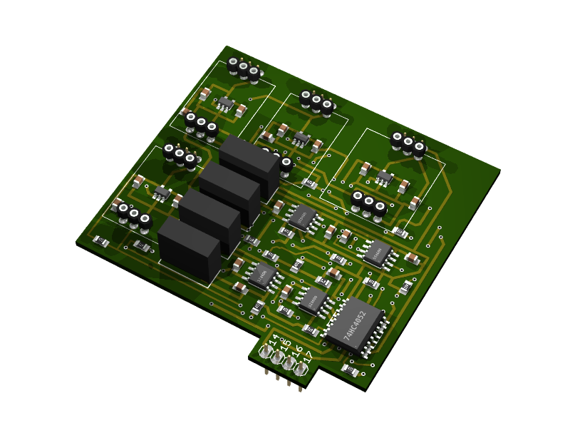

My project is based on this shield. :D
I have all done.
Can you make a PCB with 2 layers?

Fernando that is a great looking board I was wondering does it only support ezo chips or does it also do 5.0 can you run ez and 5.0 at the same time? the regular uart board has problems when doing that and a EC chip but we all know that and there new board is very costly
Post Number:#248 Post Fri Oct 02, 2015 9:50 am
It should work with any stamp using UART.
Have individual isolation for stamps.

The new one, I also have an issue I will figure out on my own brand new ec stamp makes the bord freak out when plugged in so I set it up on another arduino and can't get it to connect with any code I have tried.
Happy reefing to all.
Post Number:#252 Post Tue Oct 06, 2015 10:03 am
Changed the baud rate to 38400 on new stamp?
