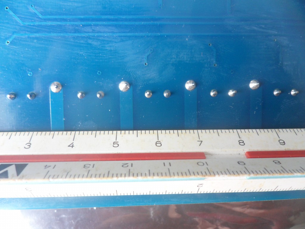

I have an observation for you.
This is my relay board:
As you can see the specification says 125 V / 10 A but, look the PCB trace width:
The width is 3 mm, using this calculator the maximum load for this width is 5.3A.
So no matter if the relay can work at 10 A if the PCB trace can't.

Hi, the new relays that I just got have a thicker and wider trace than the others, I asked before I bought them. trace is 5.5mm wide and 2.5oz thick. thank you for the info and, could you post a link to the calculator you showed?
